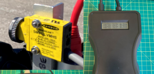

I attempted this: used a Keyence laser distance sensor to count RPMs and an STI CMCP785A to measure acceleration. As you identified, the data analysis was the hard part -- I got good, realistic seeming data using a test setup on a lathe, but I had a hard time getting the data to properly locate and quantify imbalances when I artifically induced them. I never got beyond my test bench setup before I decided to just buy an ACES probalancer, but I kept all the parts to come back to some day.

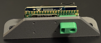

I think this is actually a remarkably good start. There are a few differences I had in mind.
  • Processor - I'm starting with an RP2350 on a pico 2 w board. I considered an ESP32 and think it would be a good choice here. Ultimately, it really came down to me wanting to try out an RP2350. I just finished up a project with an ESP32 where I think the PIO of the RP2350 would have been very useful. I didn't want to go that route since I hadn't used one before. But for this project, an RP2350 with it's dual 150 MHz cores and DSP/floating point instructions sounds like a great fit.
  • Accelerometer - As with your document, I plan on starting with an ADXL345. I do question if the precision and noise floor will be sufficient. I think the ADXL355 would be a better choice. But they are more expensive and I already have a few ADXL345s on hand. This should be an easy substitute later if I need to upgrade. (By my calculations, to read 0.05 IPS at 2200 RPM, the accelerometer will need to measure 0.03 g. Such a small signal will be difficult to read among all the other vibrations.)
  • Optical Sensor - I don't think the TCRT5000 would be a good choice here. The datasheet mentions a 'DISTANCE RANGE FOR RELATIVE Iout > 20%' of only 0.2 to 15 mm. I'm pretty sure we'll want more range than that. I'm also looking at sensors with modulation filters for additional ambient light rejection.
  • Display - I think I'm going to skip the display on the unit. Instead I'll go with a BLE connection and an app. Also will add an SD card for data logging.
  • RTC - I plan on adding a real time clock just to be able to time stamp all logged data. This should make it easier to sync with my G3X log files for further analysis.

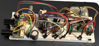

Glad to see that other people are also interested in a DIY Propeller Balancer. I built two hardware versions based on ADXL335 vibration sensor and an Arduino based signal processing, including its built-in ADC.
Vcheck_V0 is an Arduino Uno based device with crude point to point wiring. No pcb other than a perf-board. Vibration sensor is built upon the ADXL335 demo board, using a 3AA flashlight housing (slight modification and some epoxy).
Vcheck_V1 my productized and test-platform using an Arduino Nano, having two sensor inputs (I had plans for testing helicopters) encased in a professional sturdy housing with AA or 9V battery(-ies) that seems to be quite similar to one of the commercial analyzers. I also designed a PCB for the vibration sensor that gives access to 3 axes, temperature sensor (I was looking at possible a semi-permanent installation), and current drive buffering to drive the signals via a cable to the signal processing/display unit. Most of the features embedded in this design are not needed to perform basic vibration balancing functions.
Both the V0 and V1 versions run on any DC voltage from 3V to 16V.
The software performs quite well and makes use of Discrete Frequency Transform (a subset of FFT) and seems to be quite effective. The puny ADC of the Arduino is tapped to its max performance by sampling the next vibration level only when the previous data has been sampled and stored in the appropriate data bin (e.g. 120 bins of 3 degrees of propeller rotation... which can be changed by the user). No super high speed ADC needed.
As a system I have tested about 6 aircraft and brought the vibration levels from .4 ips to about .05 to .07 ips.
You cannot use just any optical sensor and claim success. I have tried a couple of low cost ones and they failed miserably at around 1600 rpm. I used a Banner Mini-Beam SM312LVMHS optical retroflective sensor which works great (stable, accurate, fast response time) and has no issue working in sunlight, unlike some infrared sensors I tested. Downside...$$$. It is about $200. I have sampled another brand of retroflective sensor for testing and it looks very promising, and cheap too... $20. More to come.
You can find preliminary schematics and some info at my Github site: https://github.com/Lycosaurus
I did a presentation to our EAA group a little over a year ago which you can find in the above Github site under the Vcheck_V0 folder.
As you can see, the documentation is a work in progress and I have been hampered by "life", including engine rebuild on my RV9A. I hope to find some time and motivation to fill in more blanks in the documentation.
I have no ambition to sell anything... just doing this for fun. You are welcome to use the information to build or design at your own risk and discretion. I claim no ownership.
I made a first quick (cheezy) video of my test setup uploaded to Youtube (see Vcheck_V0 folder). I have plans to post more videos of the Vcheck system as well as the successful field testing on my (victims) friends planes. Let me know what/if is of interest to you.

I've got a basic UI up on an esp32S3 supermini webserver. I'll order some parts and play around. Cheap fun.

Here's another video that mentions a couple of optical sensors in the video description.
Looking at the datasheet for the QRD1114, its max sensitivity (max collector current) is with a distance between 20 and 30 mils. That's 0.025" or 0.6mm!
Didn't find that spec for the ITR20001/T.
Just something to be aware of in addition to shielding from ambient light or heat sources.
That's probably why Dynavibe and others are using the more expensive laser position sensors.
As I mentioned, I have my photo LED/transistor in a 1/2 CPVC tube to shield from ambient light and very close (<1/8") from the spinner back plate which is 1/2 painted black to produce a square wave. (Actually added a piece of thin reflective tape just before the black to get an sharper start edge.)
Yeah, I noticed that too. Better alternatives ($$$) would be sensors like the Omron E3Z‑R61 / R62 or the Keyence PZ‑V/M Series. Or do like you did.
I'm currently testing a Vishay TSSP77038. It's an "IR Sensor Module for Reflective Sensor, Light Barrier, and Fast Proximity Applications". The data sheet claims it will work in presence detection applications up to 2 meters. Where I plan on mounting it, it will only be 2-3 inches behind the spinner. One of the nice features of it is a bandpass filter in the reception circuitry. It doesn't trigger off of steady light. It needs to see a 940 nm light modulated at 38 kHz. This greatly improves it's ambient light rejection.
One down side to this sensor is that it has a fairly wide field of view. This obviously is not ideal for this application. So I plan on 3d printing a housing around the receiver with a small aperture to limit it's view.

Here's the hardware I've been working with.
It's got a Pi Pico 2 W (RP2350) microcontroller, ADXL345 accelerometer, DS3231 real time clock, TSSP77038 IR receiver, IR333-A IR Led, and a 1 gigabyte SD card. I've almost got the firmware and app to a point where it's ready to mount to the plane and log some accelerometer data. The problem is, there's no way I'm bolting hardware like this to an airplane engine. It needs to be repackaged.
I'm sure I'll hate myself later for making this so tight and not leaving much room to run wires. But here's what my current proposed packaging looks like.
Screenshot 2026-03-18 at 10.54.37 PM.pngScreenshot 2026-03-18 at 10.55.26 PM.pngScreenshot 2026-03-18 at 10.55.42 PM.png
The 3d printed gray angle piece is 3.75" long and I'll fabricate that out of 1" aluminum angle. The black plastic housing will be reprinted in black ASA. As will the currently green IR LED/receiver housing. The accelerometer board will have washers under it for spacing and be secured by four screws directly into the aluminum. The bottom part of the case is secured with four screws from under the angle. The remaining boards slide into place and are secured by installing the case top with four screws. When installed, the sd card sticks out just enough to grab it. For now, power is supplied through a micro usb connector. I'm pretty sure that's about as compact as I can get it without a custom PCB. That's for the next revision. After I verify if this will actually work.
This will be bolted to the gearbox using the two holes circled in the image below. That should place it behind the cowling, and just far enough inside to have a clear view of the backside of the spinner.
Screenshot 2026-03-17 at 10.04.43 PM.pngScreenshot 2026-03-17 at 10.07.08 PM.pngScreenshot 2026-03-18 at 11.19.37 PM.png
Based off what I've been reading, accelerometer placement and mounting is super critical. While I think my approach is pretty solid, if anyone has feedback on how to improve it that would be appreciated.
