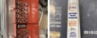

444TX
Like others have posted, the proper tool in the best way to go. The mags studs might be easier than larger cylinder and case studs, but still the way to go.
The lead based anti-sieze is available on line. That’s what should be used, but loc-tite will work.
