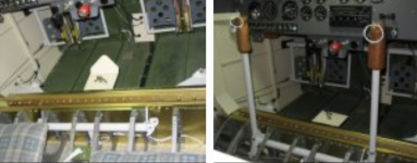

Just for reference -- two photo attached from my RV-9A build between 2000 and 2004. When I'm working under the forward seat pans, I like to keep the floor-rib removable bridge sections in-place for added floor rib strength. I also sit back away from the forward ribs with a cushion or pillows, which prevents over stressing the forward floor ribs. These ribs don't have much strength without the removable bridge sections in place and the floor pans screwed down.
