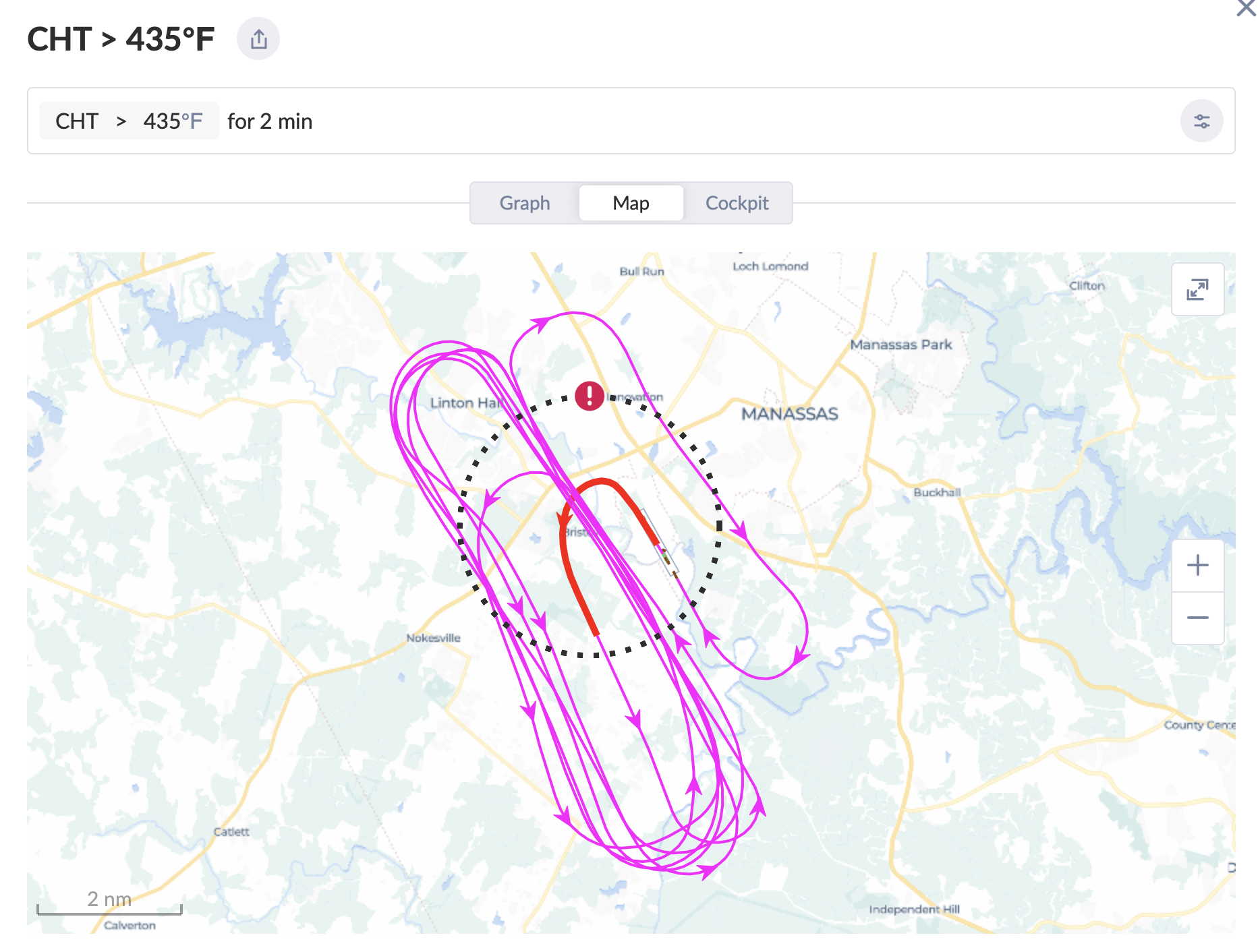

IO-540-D4A5, Hartzell 2 Blade Constant Speed, SDS EI CPI2 (right side), Stock Mag on Left Side.
Also recently found some up/down movement in the cowl at the cowl pin hinges near top/center. I fabricated 2 new pins that are 0.120 vs 0.091, and I am able to get them installed (one with effort; one with a lot of effort). A vibrating/clicking noise at specific RPMs during ground runup may have been attributable to that cowl movement. Certainly the noise when pressed up/down manually was same/similar to the clicking heard while engine running. No addition starts/data since the cowl resin yet.

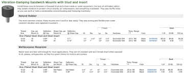

Ultimately after coming up with lots of things that could vibrate I knew that deep in the back of my mind I’d never be happy shooting an approach knowing that some random vibrations from something as insignificant as a cowl pin could leave me without an AH.
The epiphany came when the RV12 “acoustic noise energy” (aka vibration) SB came out. Put simply in the context of all the mounting instructions that the manufacturer gives you - you are on your own. Garmin has done precisely zero research on particular experimental airframes to make sure you have a mounting position that has sufficient vibration or noise (however created) isolation.
They make it worse by prescriptively telling you where “not” to mount it (on the back of the GDU) when it appears that seems to be an almost universally successful mounting position.
They tell you it has to be as stiff as possible ( I had them mounted on the spar carry through at one stage - I challenge anyone to find a stiffer part of the airframe - no good) then solve the RV12 problem by mounting it on rubber bushes. Go figure.
