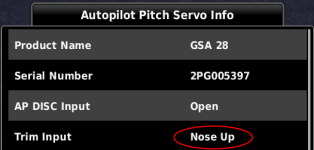

Since you mentioned the trim position indicator not changing color, I'm assuming that you have your trim switches connected in such a way that under normal circumstances you do see this effect. This information comes from the GSA 28 autopilot servos, which feed data back to the GDU display to tell it "I see a manual trim input". If you are activating the trim switch with the autopilot disengaged, and sometimes you see the position gauge change color and sometimes you don't, that most likely suggests a wiring problem upstream of the autopilot servo.
The next time this happens, go to the System Information page and look at the detailed information for the relevant autopilot servo: if it doesn't indicate that it sees a manual trim input, then you most likely have a wiring issue:
Thanks for the info, Matt. You're correct, I normally do see the trim position indicator turn blue when the trim is manually commanded.
I'll look for a wiring issue upstream of the servo, as you suggest. And thanks for the point-out on the AP pitch servo information page. Great stuff!
It's weird, because when this problem happens, I'll engage the autopilot to see if it can trim, and it always seems to do just fine. The trim position indicator on the G3X doesn't turn blue when the AP trims, but that's normal.
