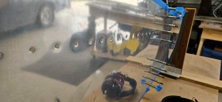

So I'm riveting the lower skin,Lower Skin.jpg empennage on my RV-14 and this is what I'm seeing....pucks after bucking - is this normal? The dimples before riveting look great without any waves. Am I being to OCD?

Are you "pushing" on the gun? Most of the pressure should be on the bucking bar. The gun should be held with just enough pressure to keep the rivet seated in the hole.
"Back riveting" will help where possible.

Yup....probably pushing the gun....wanta figure this out before working on the more visible skins....thanks
What brand of dimple dies are you using? To me it looks like the dimples might not be good quality...I've done plenty of riveting with a variety of gun pressure settings, and usually press on the gun pretty hard (balanced with a lot of force on bucking bar, but you need more pressure on the gun to make sure it stays flush to the surface) and have never had results like this. If you have any experienced builders nearby, might be worth having them pay you a visit so they can take a look at your tools, gun settings, and technique to figure out what is going on.
The dimple die is from Cleaveland. The dimples look great - no distortion/waves at all until after I set the rivets - thanks for the input - gotta figure this out.
Set at 32....
I use a 2X rivet gun at around 42# and place clear packing tape over the rivet to provide some friction to help prevent creeping of the mushroom set. About a half second of squeezing the trigger usually does it when using my tungsten bucking bar. I use a C-Frame and, like you, Cleaveland dies, really whacking the thing for each hole. There can be other reasons for it, but it looks to me like the dimples might have needed more "whacking" or squeezing.

You might be pushing in too hard with the rivet gun? I prefer to back rivet all the skin items I can. A few rivets under the stiffeners require conventional riveting so then I use a tungsten bucking bar that treats those -3 rivets like soft butter.

Cleaveland makes excellent dies. You're sure you're not using their tank dies, right?
Certainly looks like your rivets are not seating well in the dimples.

I’m thinking you might have 2 issues going on. Not making a good well formed dimples ( maybe using tank dies or poorly machined dimple tooling, or maybe poor dimpling technique . Perhaps you’re over setting the rivets and in the process flattening out the dimples to to cause the dimples to recede from the edge of the rivet head

They are fine. The “witness” mark from the male dimple die “should” make a full circle though.
The lighting here on the set rivet will make some think they are not seated well. (Shadow gap)
Lay a straight edge over the finished rivet and show us that image.
If you close you eyes and run a finger down the rivet you will definitely feel a high set rivet.
Also, if the -3 rivet is not set enough, it will not pass the minimum height test on the shop side.

With the straight edge you can see the puck marks that is my original concern. Maybe others are right...holding the gun too hard against the surface?

Yes. The gun pressure may be too high.
The gun should rest against the skin with enough pressure to prevent bounce only.
(Test on the side of the work bench)
Then use the mass of the bucking bar to set the rivet.
(I like the tungsten bars, expensive? Yes. But they set -3 rivets like they are plastic.
Anyways we back rivet as much as we can to prevent skin dents.
