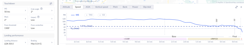

Flysto.net has a nice way to view your approach speed and IAS on touchdown which I review almost every flight.
