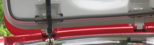

This will give you an idea of how I did it. Note that the door opening flange has been slightly widened and flattened to provide a sealing surface
Manufacturer might have a different recommendation for orientation, but this seems to make sense.

The installation shown in the photo shows the correct installation. Note that the piston rod faces upward when the door is open, and then rotates downward when the door is closed, which is the resting position. Anecdotally, this orientation is in kind with the rear hatch on my wife’s Ford Explorer.
If you’re implying that Kyle’s strut should be reversed, then I disagree as that would be counter to keeping the seals maintained.
