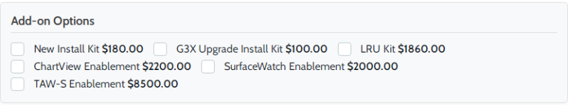

Hi @g3xpert, a few questions about enablements:
Is it possible to transfer ChartView enablement from G3X system to Axis?
If I have an existing ChartView enablement for my GTN750Xi would it automatically extend to the Axis system?
Will the SurfaceWatch and ChartView enablements be sold at different prices for certified and experimental?

Aircraft Spruce is listing the AXIS 11.6 inch units but I was surprised to see the base version options -
Sarasota also has information on TAWS option -
What terrain alerting and chart display options are included in the base AXIS display and what additional features do these options provide?
Does the base display unit provide at least the same terrain awareness and alerting, and the same chart display capability, as the GDU 460 or 465?
Yes - the base AXIS displays provide all of the same terrain awareness and alerting, along with the same Garmin chart display capabilities as today's G3XT options. There is no additional catches or charges here when considering a G3XT panel or an AXIS panel.
TAWS-B is a feature typically found in higher end twin + turbine class applications. ChartView Enablement is to enable Jeppesen charting capabilities (this charge also applies to G3XT today). SurfaceWatch is also an enablement found on our higher end integrated flight decks, but AXIS capable.
