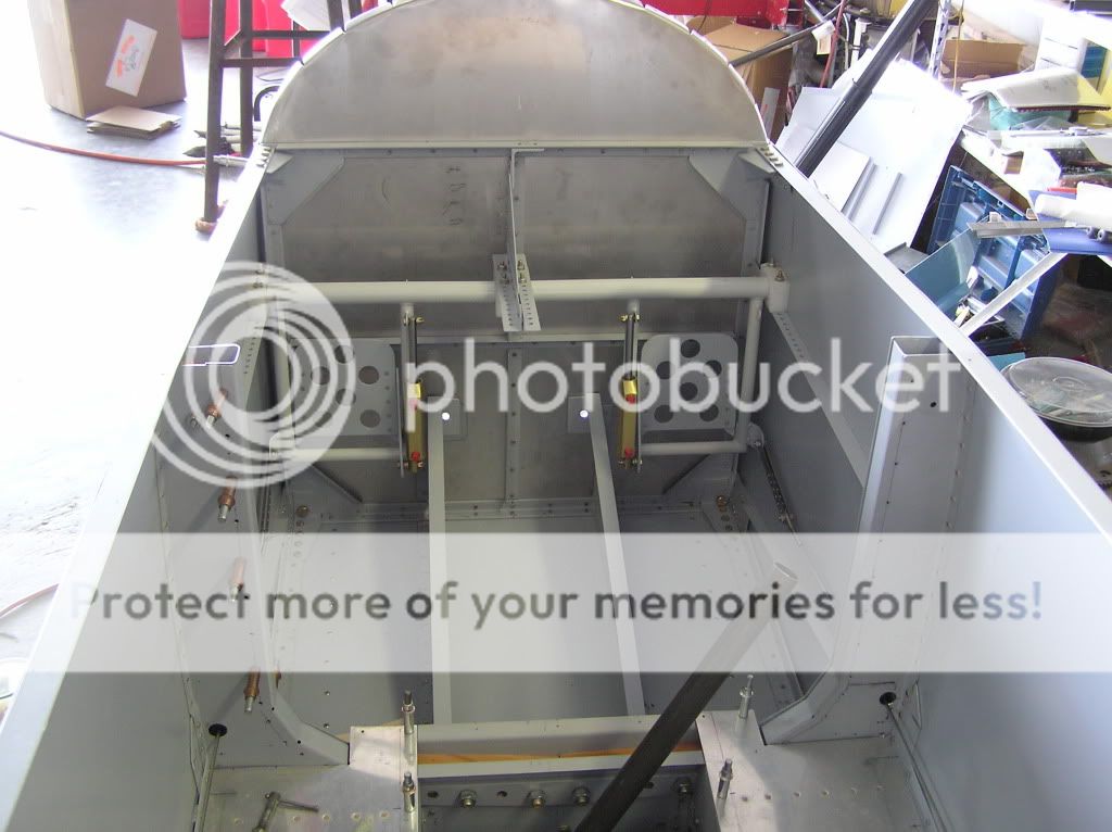

I'm building up the seat ribs.
In this photo, the important thing are those disks on the flange. These are magnets, strong rare-earth ones. They do a decent job of holding the rib flange to the web of the F-304 bulkhead. They are handy thing to have, don't use them often, but they're effective when I do. There are other magnets of the far side.
I was going to drill the holes for attaching the bearings to the mixer and found that on mine, the mixer is mis-cut. The markings show where the hole is supposed to go. I moved it slightly, maintaining the same edge distance as the plans call for. Just a head's up here on this one.
The mixer itself is 9 5/16 wide. The space for it is slightly more than 10 inches. Because the intermediate F-314 seat ribs have some beads on the lightening holes, which you can see in the next photo, the angle brackets don't rest against the webs outside of the space. They do fit reasonably well (which means that they kinda fit) inside, but then there's no room for those triangular flanges.
The brackets themselves are long enough to pick up both the fasteners to that short bulkhead, the F-304 one which is still in blue, and the .063 angles which are riveted to the F-303 spar bulkhead on the right. However, there's another bead for the next lightening hole to the left which takes up much of this space at that end of the bracket. This is still in progress.
Those rectangular tubes above the spar simulator are nothing more than spacers. My simulator came out a little shallow in the center area, my fault, and these keep the flanges the right distance apart. Ugly, aren't they?

I made two more of those tube affairs (reference post #240) for the tailpost support. Since my jig is an RV-4 Fry jig, the tailpost's jig position was essentially fixed. But these moved the aft bulkheads, the F-311 bulkheads, into the correct location.
You can see that I'm using two of the bulkheads back to back. This probably looks normal to many of you. However, on the RV-3B, the plans call for only one of these. I'm taking David Howe's advice and adding the second.
Next, I placed the remaining bulkheads in position. These and the longerons which I cut and rough-fit will all need some tweaking. In most cases the bulkheads aren't planar. When I first placed them in position most of them were loose in the top longerons. That is, the longerons were spaced wider than the bulkheads. I moved the bulkheads to where they fit and moved the fixture's supports to suit.
In the middle of all this I noticed, one hot day, that one corner of the shop had a nice breeze. It was pleasant. Then I realized that there shouldn't be a breeze there, especially not a localized one, and about that time the compressor kicked on. I've got two regulators and run two flexible lines, 30 psi and 90 psi. The 90 psi line had a small split. I used it for a day or two and then went to HD and bought a replacement. The new line is 50' instead of 25' and while the additional length is nice, storing it is a bit of a pain.
One of the things that is not per plans is that the tailspring support that the factory supplied is the one for an RV-4. The plans show the RV-3 one but Van's doesn't make those. In fact, The List doesn't even show it. The RV-4 one is slightly larger than the RV-3 one and worse, it slightly larger than the space for it on the aft bulkheads. I trimmed it slightly and now it fits. As KatieB pointed out above, building an RV-3B includes a considerable amount of making things fit. In this case, besides having the end fittings being larger than they should be, the support is 1/16" longer than it should be. That's not so much but it affects the F-310 bulkhead position, and I doubled up those, too, again per David Howe's suggestion.
There are still many pieces to fabricate and fit. I've nearly run out of those excellent Cleco side-clamps and bought another couple handfuls of c-clamps today.
In case the photos aren't showing, they are also hosted (in larger format) here and here.
Dave

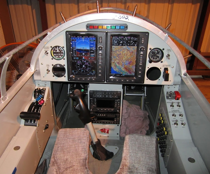

Field Trip
Recently, I got to see a remarkably well-built RV-3B under construction and was treated to what amounted to a one-day seminar in advanced techniques. The builder, David Howe, has previously built an RV-4 and then a Rocket. The Rocket is flat-out beautiful, and it looks as if the RV-3B will be at least as good. Its fuselage skins are so smooth and fair that you almost can't see the rivet lines.
I'm not going to go into specifics because those are, in many cases unique, and I think that it's up to him to show what he's developed. So this is an abbreviated report mostly describing my field trip. It amounted to a one-day seminar in advanced construction techniques.
He made a number of professional-looking tools. These include everything from custom wing supports to bucking bars to rivet sets to jigs for a single-use operation. Typically, I use wood or aluminum for my tooling, as you've seen in the photos. He'll weld up some steel and he's not afraid to go stout. Since stoutness means stiffness, and stiffness helps precision, this all adds to the quality.
One thing he's been doing is bonding his skins to the frame. The main reason he does that is to use the bond as a variable-thickness shim. He also uses shim segments of aluminum to reduce the bond-line thickness. The bond serves another purpose as well, in that it holds the skin in place while riveting. Extra work but the results are superb. We went into some detail on this and I might do something along these lines on my plane.
One thing that as an engineer, I really appreciate, is that he tests virtually every non-standard thing he does. He has his own pull-tester, for example. And he's cycle-tested the end attachment to a push-pull cable that he built.
Some of the changes he's made are strictly to enhance the utility of the airplane. One example is a built-in, easily removable toolbox that fits in one of the few unused areas in the RV-3B cabin area. Normally, you'll never know it's there, yet it's easily accessible when needed.
I've been putting in flutes to straighten the bulkheads and ribs in my plane. We all do that. He has a shrinker/stretcher pair on a stand and corrects them that way. I'll be getting a set of those this week. Incidentally, he pointed out that you don't need just a shrinker, but both, because otherwise you'll always be changing jaws from one to the other, after slightly over-doing it one way and needing to go the other way just a bit.
He's made some fittings that look a lot like those standard blue AN fittings, same blue anodizing, same general sizing, but which have custom configurations for a particular need. Looking at these on the plane, they're very easy to overlook, never guessing that they aren't standard AN fittings.
He'll have redundant fire sensors and a fire-suppression system in the plane. Race-car equipment, and readily available.
His plane abounds with cool little ideas for the RV-3B. I'm not going to steal his thunder on these here, but I might steal some of the ideas and incorporate them in my RV-3B. I do have to admit that here and there, some of them do add a bit of weight, but not all of them. Here's a view of the baggage floor rails with flanged lightening holes. He made the hole flanger tool, of course.

The new seat angles are fabricated. They went relatively smoothly. I had to work on the flanges to remove most of the roughness from the shrinker/stretcher, which does leave a mark in 6061-T6.
In both pictures, the top one is the new one and the bottom one is what I'm replacing.
It leaves less of an impression in 2024-T3. I used it on the flanges of the F-306 bulkhead to flatten it up while I was fitting the baggage floor rails.
There were fewer marks in the 2024 bulkhead flanges but then of course I was using it more gently. I've decided: the shrinker/stretcher is a good tool and worth having.
By the way, when I started fitting the baggage rails to the F-306 bulkhead, the bulkhead was about an inch aft of it's proper location, clamped to the aft face of that aluminum rectangular tube on the jig (the one that it is now clamped to the front face of). It fit well there, except for the baggage floor rails, which weren't long enough. I moved the bulkhead forward so that the rails would fit, but then the bulkhead was inside the longerons. I hadn't glued this bulkhead yet since I had a feeling it might need tweaking. I unclecoed one side from the other side and spread them apart slightly and clamped them so that they fit to the longerons. Then I reclamped them where they joined in the middle.
I'll have to add splice pieces but it's not a big deal: about .10 inches at the bottom and about 1/2" at the top, more or less.
I'm glad I thought about doing that.
The tailspring mount is clecoed nicely in between my F-310 and F-311 bulkheads where it belongs. Both of these bulkheads are now glued together - you'll remember that I doubled up both of these.
The F-310 bulkhead is riveted, too, to the stabilizer mount bars.
The photos are also here, here, here, and here.

The side-clamps holding the bulkheads to the longerons finally got themselves replaced by clecos. It was fun drilling holes for a change after all that measuring and tweaking and flange straightening.
One of the things that was necessary to do was see if all four splice plates would go in after the fuselage was all riveted together. As received from Van's, they are bare steel, covered in oil. I cleaned them up and lightly primed them.
There are two different styles. Two of the splice plates have square edges and the other two have one rounded edge. It was pretty clear that the rounded edges fit against the lower flanges on the spar bulkhead, and that the square edges fit on the top of the spar bulkhead. The splice plates are marked "fwd" and "aft" and there were one of each style for both locations. I was glad to see that since it meant that I didn't have to worry about which went where.
The aft splice plates went in to their positions nicely, even with the mixer in place, although I removed it for the photograph.
The forward top one went in easily. Unfortunately there's no way that the forward bottom one will fit after the fuselage is riveted. I'll have to have it in place during that operation. Since there are some serious rivets going in close to that splice plate, this might get tricky at that time.
Please remember that I changed my F-312 firewall reinforcement pieces to be more like the RV-4 and pick up both top and bottom splice plates. The stock F-312 pieces provide ample room to fit that splice plate without much drama. I tried to allow for clearance for this but it's just not going to happen.
The photos are alternatively hosted here, here and here.
