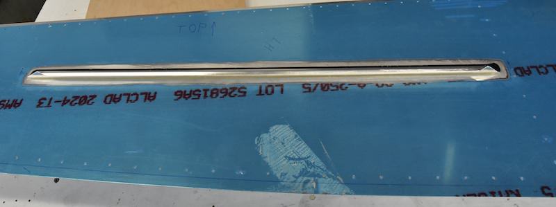

I've been getting the smaller details completed. The gussets at the forward (middle of the image) ends of the baggage compartment ribs that are on the far right needed to be riveted to the seat baggage bulkhead. Here I've got the left one clecoed and am using a .063 plate to ensure that the right one is fair to the seat bulkhead while I drilled the flange.
I worked my way aft, bulkhead by bulkhead, deburring and priming parts. The aft-most two bulkheads, F-310 and F-311 make an assembly with the tailspring mount. They'd been lined up and clecoed. I drilled them out to 1/4" and installed temporary bolts. Then I removed it and put it on the table for its portrait.
Later, I disassembled and primed the parts. They are now reinstalled.
At that point, I removed the top longerons for deburring and priming. These support the fuselage frame on the Fry jig. After they got detailed, I reinstalled them and clecoed it all together. Before checking the overall rig of the fuselage, I decided to recheck the trueness of the Fry jig itself. In the photo I've got the SmartTool digital level showing that the jig is level crosswise. This is looking up (the fuselage is upside down) and aft from the firewall through the forward tunnel area.

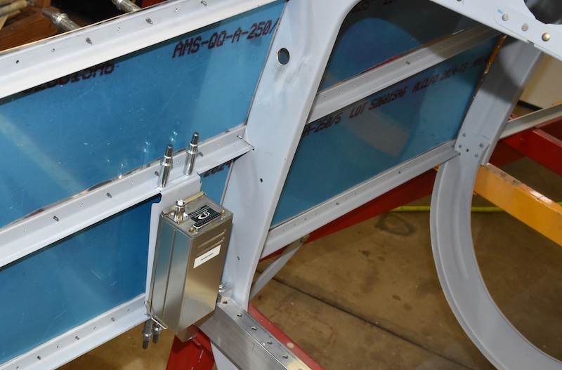

Had to do something about that. It seemed best to work from the center out, so after riveting the F-304 bulkhead to the F-313 center seat rib, I riveted the seat rib to the F-305 bulkhead.

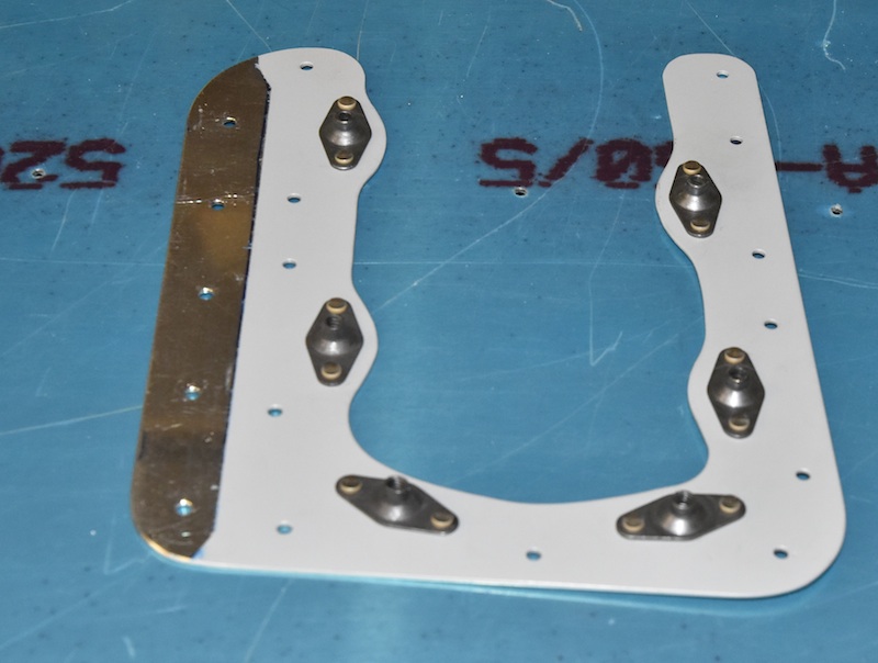

Next came the middle non-center seat ribs, the F-314 ribs. These have the mixer mounting bracket attached, so I had to rivet those on first. After attaching these to the fuselage, I had this.

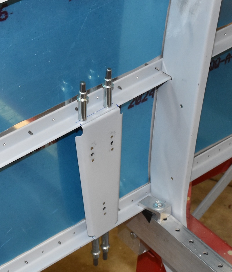

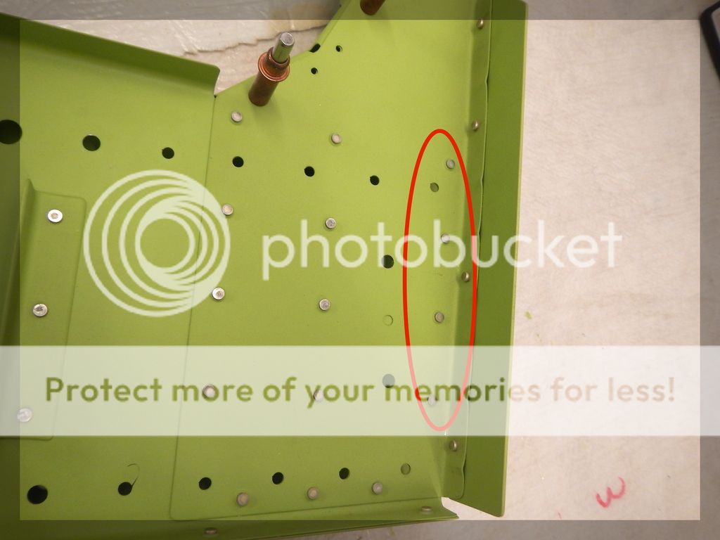

Then I clecoed in the outer seat ribs, the F-315 ones. Guess what? There are a couple rows of rivets which are buried in the F-303 spar bulkhead. I forgot about these when I riveted on that bottom splice strip, the blue one just above the marked holes in the photo. Oops.
I've taped some rivets in place for these and arranged for someone to come out and give me a hand with these. I think that they can be back-riveted. We'll see.
The proper sequence would have been to back rivet these to the bulkhead before I riveted on that splice strip.

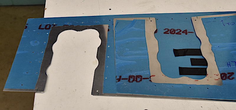

While I was waiting on my helper, I got busy with the rudder pedals. The rudder pedals come pre-welded and the brake pedals need some fabrication and assembly. The plans show the shapes, leaving a few dimensions to our imagination, so I built a set of the side pieces to the plans. They didn't fit, with the brake pedals interfering with the top forward corner of the rudder pedals. Yes, I know that a properly maintained brake system would be stiff enough that the brake pedal probably wouldn't contact the rudder pedal, but it's so close! In my drawing, I've moved it out of the way; the as-built assembly had issues.
I'm old school and used paper and pencil to work out some new geometry, similar to the original. I taped it into my project book.
Here are the pedals all clecoed up with the new sides on. I didn't get ny photos of the original.
Here's a better view of the new side plates, including a few efforts to make them lighter.

Dave, you're bringing back fond memories for me. The fuselage skeleton section was my favorite part of the build. I just completed a major home renovation and it felt like finger painting relative to the complexity of the 3. Keep up the good work!

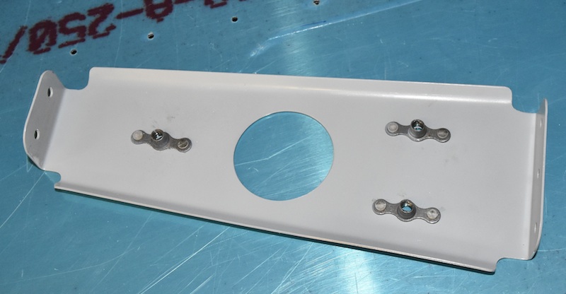

Moving along to the flap handle, another assembly that can be made now, I had the idea of using an RV-12 part, VA-110, for my RV-3B manual flap handle button. I called tech support to see if it would fit and was told that the size would be the same as for the -3 because they wouldn't change something like that. Hah! But the support guy was good enough to check it for me, and found that in fact the -12 part was too big and wouldn't fit. No surprise, really.

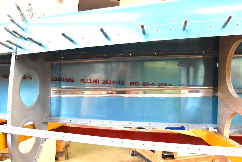

After we got those eight rivets done, Glenn inspected the fuselage. He's not a Tech Counselor but as an AI and long-time sheet metal man, he's plenty experienced. He found a couple small problems, including one over-set rivet in an easy-to-get-to area. I've already fixed one of these and will do the other one when I get back to the project.
The flap arms with bolts need just a bit of clearance at the lower longerons. This is at least the third RV-3B that needed tweaking that I know of. One of the other two bent the arms and the other also trimmed the longeron.

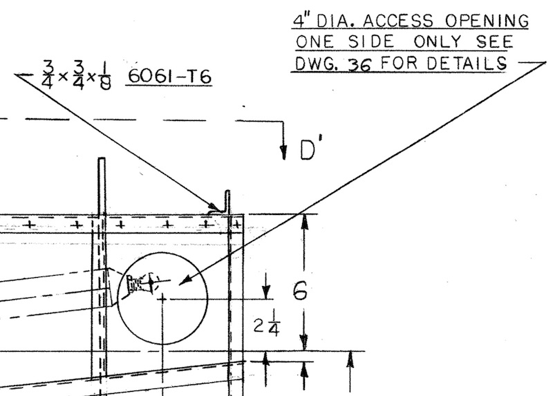

This excerpt from the plans, drawing 30, shows the part of the flap mechanism that interferes with the longeron, on the right of the picture. Remember that the bolt head sticks out farther than the arm itself, but both the bolt head and the tip of the arm need relief.
The flap latch is shown on the left of the picture. It's straight-forward enough except for one interesting detail - the zero line isn't dimensioned with respect to the seat. First I thought about that and then I checked the manual. I was glad that we agreed: first adjust the flap handle to get a good position and THEN locate the position of the notches.

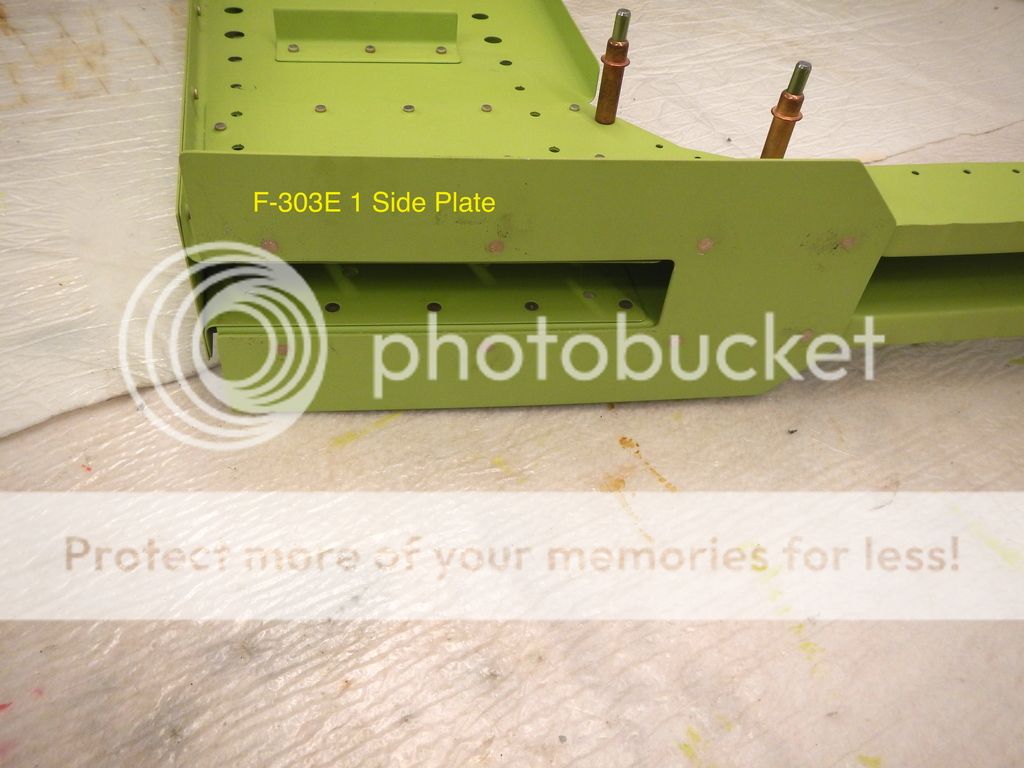

Seat Rib & Side Plate
Dave,
before starting the wing construction I decided to build the center section. What happened is, that I riveted the outer seat rib positions :mad:. Drilling these rivets out should not be a problem . Furthermore I riveted the F-303 E-1 Side Plate. Do you think I have to remove it also?
When you riveted the seat rib to the center section, wasn't it possible to insert a heavy bucking bar into the spar gap, driving the manufactured head from the seat rib side? Maybe I misinterpreted your description.
Peter
Long Bolts for your pedals..
Dave,
I was thinking about your space issue with the long bolts. Would it be possible to use a piece of threaded rod with 4 bolts instead? It would allow you to slide it into place using the space you have available, moving the bolts up and down the threads, as needed, then securing it all into place.
Peter, at a minimum, you'll have to remove the rivets in both the red and blue ovals. Both of those go through the F-315 seat ribs, at least on my plane.
Ideally, with the bottom strip out, we could have installed the seat rib by back-riveting it when we made the aft bulkhead.
The main problem I had was that I didn't have an offset back-rivet set. If I had been able to get square on the rivet stem, I would have back-riveted the red oval rivets using a bucking bar for the back-rivet plate, as you describe. But with my tools that wasn't possible; the rivet would lean over and be unrecoverable. Glenn suggested hitting the factory head with my T set and I did that. The T set was just barely able to reach in far enough. You can see the force I'm pressing with in an effort to get enough access. It wasn't easy. And even at that, it was good that I had an expert on the bucking bar to keep the rivet shop heads straight. He had to work at it.
This tool might work but I don't have one (yet). Bent-end set from The Yard Store.
This worked but just barely: T set from The Yard Store.
Unfortunately, my tungsten bucking bar only has square ends. If I'd had one with an angled end, that would have been lots better.
Amazing - all this way and I still get to buy some more tools.
Mike, that might work but I'm not going to do that. I'll give the as-designed hardware a try since a lot of RV-3s are out there successfully using that hardware.

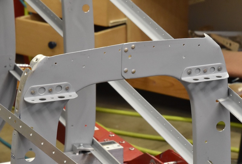

The forward firewall ribs, my version of the F-312 ones, needed holes for the fuel lines, so I cut those and installed doublers.
You might remember that I used two back-to back bulkheads for the aft-most two, F-310 and F-311. This was a modification. The tailspring fitting that is included in the kit is from the RV-4 and is a bit larger than the RV-3 design so I jiggled it around until it fit. The issue is that the side flanges are too wide to fit in between the forward-facing flanges of the F-311 bulkhead that I added.
Like all modifications, there are after-effects and ramifications. What I should have done was to weld some new flanges to the fitting and then whack off the original ones. That would have been the smart move, and even after I'd seen that done, I didn't fully understand it.
What I did was to mount the tailspring fitting higher in the aft-fuselage than the plans called for, by about 3/4 inch. In the photo, that's lower since the fuselage is upside down now. The additional bulkheads are the ones to the left.
This gave me a couple new issues. One is that there's no way to buck any rivets (and in at least one location, to even insert a rivet) through the skin and the bulkhead flange because the tailspring fitting's flange is too close to the skin. The other is that the aft part of the tailspring fitting is used to also hold the lower vertical stabilizer mounting bolts.
The first issue can perhaps be handled by using some Cherry blind rivets there, in at least one of the locations.
The second forces the vertical stabilizer and rudder to migrate higher by that same 3/4 inch. On one hand, that preserves the clearance between the bottom of the rudder and the tailwheel assembly, so that part's good. And while the empennage fairing will have to be redone for this, the word is that the RV-3 fairing pretty much needs some gross rework in any case -- so that's not a new problem. There's a minor structural issue because the upper vertical stabilizer spar mount also needs to move up by that 3/4" distance to keep the same spar-bending moment on the joint (otherwise it would have 3/4" more span and therefore more bending moment, you see, because it sticks up higher).
There's going to be a fit issue at the forward vertical stabilizer mount but it's too soon to assess that.
I made a full-size drawing of the actual as-built fuselage geometry to sort through these things. A friend had given me a partial roll of brown floor-covering paper and I've been using that all through this kit. It sure is a help! Thanks, Rob.
Then an issue that my mentor had pointed out came up, where to put the holes in the bulkheads for the rudder cable? They definitely needed moving, if only slightly, because the rudder horn will be higher. The plans call for the holes to run fairly close to the outsides of the bulkheads.

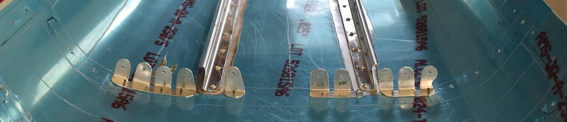

Moving on to the manual trim cable, there are two two control mounts included in my kit, an RV-3 one and an RV-4 one. The RV-3 one is larger than the plans says, and the RV-4 one is smaller. I've clamped the larger one in place for this. You can also see one of the rudder cable bushing holes.
Here's the tentative routing path aft, subject to some adjustment.
I tweaked the cable path after this photo to ensure that the trim cable would not interfere with the rudder cable and would be positioned to carry it to the elevator. Then I located the holes in the bulkheads except for F-309, and drilled them. Since they are indistinguishable from the rudder cable holes, being the same 5/8" diameter, I labeled them.

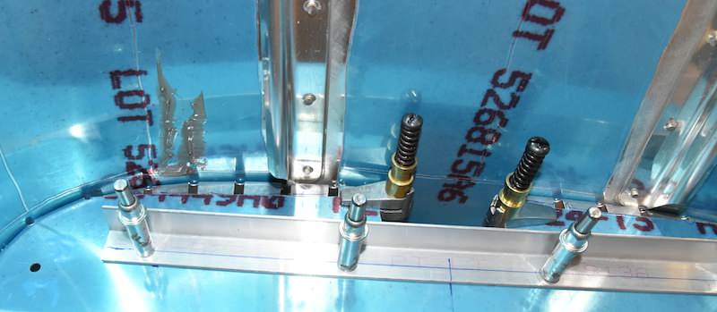

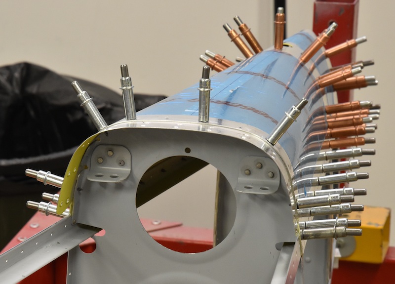

Skin in the Game
According to other builder reports, the aft-most bottom fuselage skin is especially difficult. It's thick at .040 and arrives poorly bent. Mine was no exception. I spent some time attempting to unbend the bends that were in the wrong place, and rebend the skin with bends in the right places.
One thing that makes the aft portion, around F-311, easier, I've read, is making the slot for the tailspring mount to protrude. Remember that mine is a bit higher than standard? In my case, it looks as if it'll be completely covered by the skin -- so no relief there. No access slot required.
Unfortunately I didn't take photos of the as-received condition.
After working at it a couple days, here is the skin resting on the F-309 bulkhead, the most forward bulkhead this skin covers.
Here is the skin resting on the F-311 bulkhead, the aft one with the tailspring mount.
It appears as if, with a bit of help, this connection will fit reasonably well.
Here are the tools I've been using to unbend and rebend the skin. The table is an essential part of the tool assortment.
I continued to work on it, and today I was able to make a first attempt at clamping the skin on.
Here's the F-309 bulkhead.
I moved my collection of aluminum angle so that I could get under the fuselage jig, poked my head into the innards (this is the first time the fuselage has had innards to poke my head into) and took a photo of the skin resting on bulkhead F-310. There's still work to be done.
At the back, though, it fits pretty decently.
The fit at F-310 needs some work. A friend suggested driving over it with my truck and after working on it for a few days, I believe that just might be necessary. But before I resort to something that extreme, I'll think about it for a while. Remember that so far I haven't added straps. They'll probably help, of course. I made a couple Howe Fittings (review the wing skin postings for those nifty strap partners) and have a couple more to make, and might think of something else.
Kind of hope so.
The pictures are also posted here, here, here, here, here, here and here.
Dave

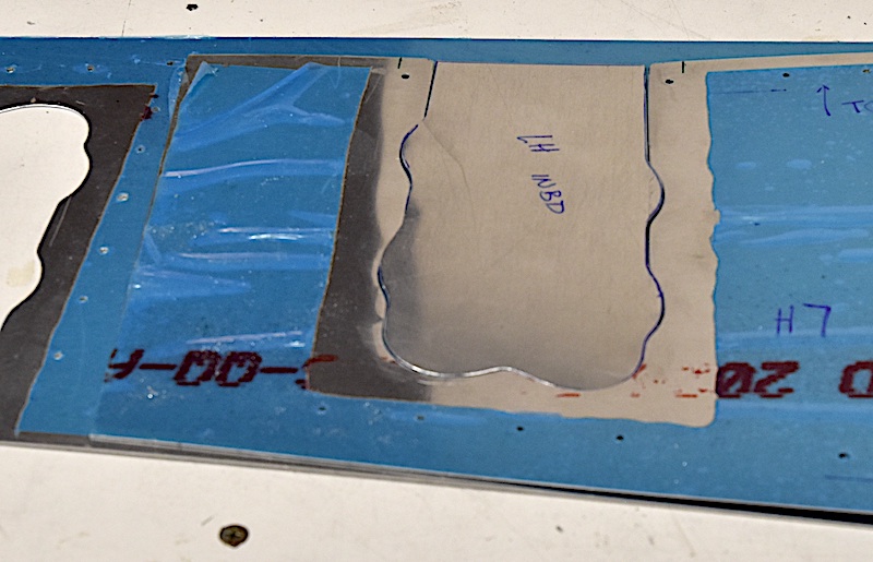

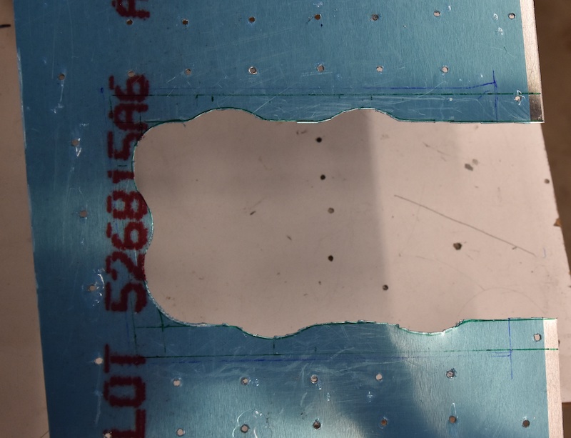

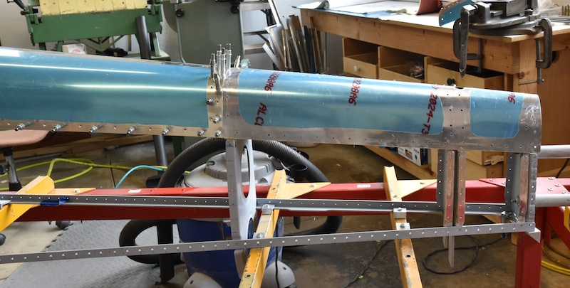

Bottom Aft Skin Games
While I was working with the aft bottom skin on my RV-3B's fuselage, I got to a point where I wanted to remove the blue vinyl.
So I did. Under it, the aluminum was translucent. It was a total surprise. I can't figure out how Van's did that. I've never seen aluminum do that before.
I kind of like it. What do you think?
Ok, I missed the first of April. Meant to post it then. What happened was that I bought a sheet of .020 polycarbinate and didn't bother to strip it's protective coating off, any more than I have the skin. I rough-trimmed it and clamped it in place so that I could easily assess the underlying fit of the bulkheads and longerons. It didn't work out so well, the polycarb being a bit too flexible for the job.
Incidentally, I bought sheets of .010, .015, .020 and .030. Of these, this was the closest thickness to optimal and I could cut it with scissors.
The main area that needed more bending was the bottom center at F-310, the second bulkhead from the tail. After a number of approaches that didn't work out, I found one that did, and succeeded in bending this area a bit more.

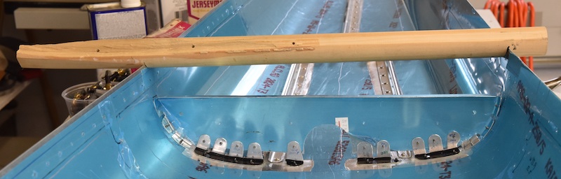

Here's the basic idea. I clamped pieces of 1/2" plywood to the sides to protect the skin, and used the darker steel clamp to mostly squeeze the sides of the skin. The steel clamp by itself didn't bend the skin much, plus as the sides bent in, the clamp started to wander closer to the edges. So I added the orange clamp closer to the area I needed to bend more. That did the job nicely.
At the F-310 bulkhead location, the dimension between the plywood pieces when the skin was maximally clamped was about 1.85 inches. This gave me a bend that closely matched the bulkhead. I'd previously tweaked the existing curves a bit, which definitely helped.
I didn't want to squeeze the aft end too much, so I placed this piece of dowel there, clamping it at the forward end of the skin. I should have also clamped it at the aft end but the fit at the tail is pretty good as it is now.
The short piece of plywood led to a skin ding. The plywood was simply too short and I should have caught that.
The ding is easily small enough to fill later. A wide friend of mine had a saying: "If you want it like downtown, take it downtown." So instead I took this skin to a local auto body shop, where they bumped it out for me.
Here's a view of the F-310 bulkhead with the skin clamped in place. We're looking at the forward bulkhead, since I've paired two of the bulkheads (the plans only specify one of the pair and I put two there, back to back). There's a substantial gap which I get to deal with. The aft flanges (the flanges at the rear of the pair face aft) actually fit reasonably well.

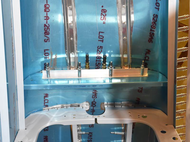

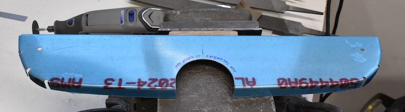

The aft bottom skin passed a small milestone last night. The clamps came off.
Remembering that the aft two bulkheads are doubled up, you'll realize that I've only drilled and clecoed one for each pair. So far. What's going on is that there are some gaps between the flanges for the forward of both the two bulkheads and the skin, and I don't want to drill those until I've got shims in there.
Since the bulkhead pairs are glued to each other, front to back, I can't simply take the flanges off and rivet new ones on. I'd ordered several F-803CPP for just that eventuality and they were on hand. These are the strips that make a perimeter flange for the RV-8 instrument panel; they'll probably do the same job for mine. I'll actually need to shim these gaps.
It's a subtle thing, but the tailspring mount is not attached at the moment. The way I located the skin/flange holes was to first drill the bulkhead and longeron flanges and then back-drill through the skin. That wasn't much fun. I needed both a right-angle drill and separately, a 12" bit for my regular drill, to get most of the holes. Four were blocked by the tailspring mount, so I removed it.
Note that after the skin is riveted on, the tailspring mount isn't removable without replacing the skin - it's got to be right when it's finally bolted in place.
After the mount was gone, it was possible to drill those holes. Since I expect to use Cherrymax blind rivets here, setting them should not present a problem; there's room to get them in.
Also, there's a hole in the skin that I still need to drill for access to the tailspring attachment bolt's nut. And lots of trimming, of course.
