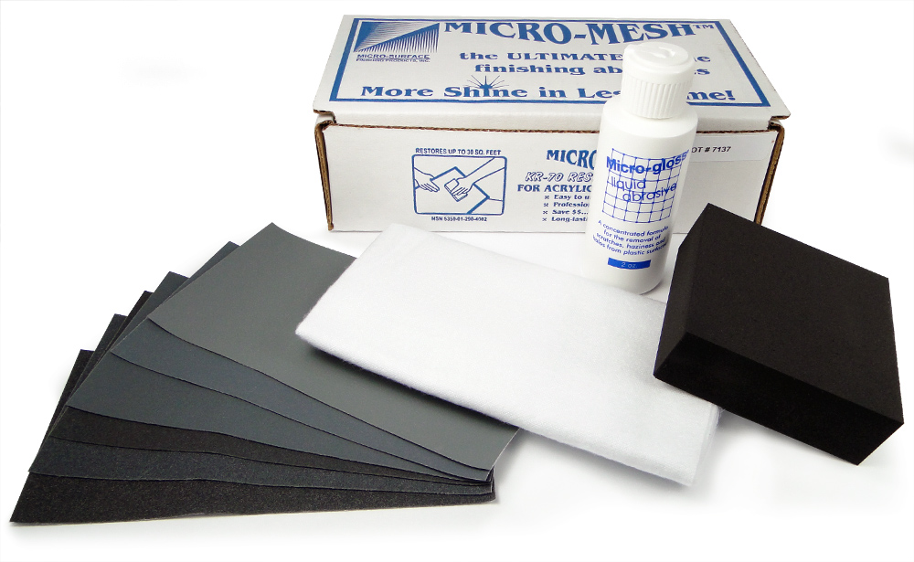

Looking for some suggestions for repairing scratches on the plexiglass wind screen. These scratches are more surface and can not be felt with a fingernail.
Thanks, Lane
For a light scratch as you discribe, Novus #3 followed by Novus #2 then Novus #1 as the final (and everyday) cleaner.
For a deeper scratch you can LIGHTLY wet sand with ~1000 grit paper, then above.

Try this
