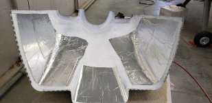

Did you guys use any type of adhesive on the fiberfrax? If so what?
No adhesive other than aluminum tape. Depending on the size you may need to cut the FiberFrax a little small so you can tape the side. Have the adjacent patch of FiberFrax cover the tape joint, butting up to the first patch. Add more tape.
I cover this all with the self adhesive stuff from Vans as mechanical protection. If you look closely at the photo you can see the area where there is FiberFrax under the aluminum foil.
Carl
