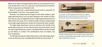

I'm far from pro :ROFLMAO:, but you'll get the hang of it after a while. Just for reference, these are what I tend to use:
Deburr handle with blades - great for lightening holes and edges
Hex tool - get a low torque (cheap) cordless screwdriver. One time around a hole with this does it. You can also get the In/Out single pass tools for holes, which are pretty slick
Edge deburring blade - great for long skin edges, knocks the square edge off, then a light hit with sandpaper smooths it out

If it took you an hour, you're doing something wrong. Simplest solution is this or a similar tool for holes:
Sand the flange edges just enough that a fingernail won't catch.
