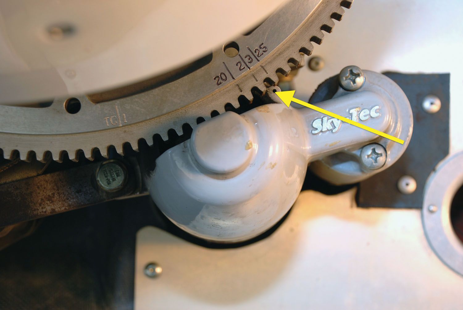

I have researched, and contacted Lycoming, re this and am still a bit confused. Have my engine at approx top dead center on the compression stroke based on looking into the spark plug hole and guessing whether I am at the top of the stroke. But, I would like to know for sure where in the stroke I am as there seems to be quite a bit of leeway as I rotate the prop between the time the piston stops moving on the up stroke and the time it starts moving again downward. In other words, lots of degrees of rotation between the place where the piston stops moving and starts moving again as the prop is rotated. I have two sets of timing marks on my starter ring gear. One set on the aft edge which I have shown in the photo lined up with the center of the engine case based on where I think the piston as the top of it's stroke. But, there are marks on the forward edge of the ring gear, as well. These don't seem to line up with anything. I have read that the marks (TP-1) on the rear should line up with the center of the case, which in my case, they kind of are. But, what about the marks on the forward edge? I read the TP-1 on the front should line up with a hole in the starter case. But, I have no such hole and as can be seen from the photo, they don't line up with anything on the starter.
I'm used to timing auto engines with a fixed pointer on the engine block closely aligned with the timing marks on the crank pulley or starter ring gear and would like to get my 390 timed as precisely as possible. And, lining up the TP-1 mark with the center of the engine case seems, well, a bit imprecise and clumsy.
Extend a straight Edge from the split line of the case and line it up with the TC1 mark on the aft side of the flywheel. Make sure you are on the compression stroke of #1 cylinder. You can ignore the marks on the front side.
You should approach the desired mark in the direction of rotation. This compensates for the backlash in the gears. I have a 6" machinists scale that is very thin. Bent as necessary to go from case split to marks on aft side of flywheel.
Since you are using a piston stop, then the technique is to ALSO use a pendulum style pointer on the prop hub. Find the number where the piston hits the stop with the prop going CW (record that number), then spin the engine CCW until piston stop contact and recorded THAT number. Do some grade school math and split the difference between the two and that’s TDC
…or just use the timing marks on the ring gear carrier:
On the BACK of the ring gear, line up the projected split line of the case with the numbers (laser or straight edge)
OR
On the FRONT of the ring gear carrier, line up the numbers with a pin/drill/wire inserted in the starter housing timing hole.
As mentioned and as shown in the photo his starter doesn't have a timing hole. I wonder what brand of aircraft starter doesn't have a timing hole?
Wow, people can make some simple stuff complicated! Assuming that you have a timing mark on the back of the ring gear, and assuming that the ring gear is properly clocked on the crankshaft, lining that mark up with the crankcase split line will set the crankshaft EXACTLY at TDC (unless the crank is twisted). Any variation in piston TDC at tat point is play that you can’t really ”adjust out”, and there is also some gear backlash between the crank and the ”ignition units” (whatever they might be). The play and backlash constitute the “+/-“ in your timing…these engines are not precise to the tenth of a degree…or even a degree. Heck, P-Mags are only accurately timed to the nearest 1.4 degree becasue of their encoder.
Set the rear timing mark to the split line, and everything else is noise.
