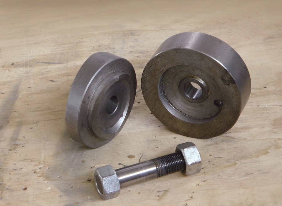

Needed a mount for a vertical card compass. Holy cow, look how expensive they are! I've got an extra range hood shroud left over from Honey's new kitchen, it's already bent and thin, perfect for a compass mount.
Last night: burned through a hole saw.
Today: Instrument hole cutter didn't even start to penetrate the metal.
Where's that scrap 050?

The punch is assembled backwards, with the cutting edge pointed away from the female side. If that's truly the orientation you used, that's why it only folded the metal instead of cutting.
View attachment 120874View attachment 120875
Ok, everyone, time for me to eat a big humble pie, I made a huge mistake.
Earlier today Member hgerhardt posted that I has assembled the punch wrong. I posted in reply that I was cutting a 2 1/4 hole for a compass and that bit was inside. But my Spideysense was going off, and I went and retrieved the punch. hgerhardt was, indeed, correct. It turns out that there are different "receiving" sides for the punch, and knowing just enough to be dangerous I used the wrong side for the receiving end. I just assembled and used it correctly, and it worked fine.
I apologize to hgerhardt, and to any others who read my now deleted post replying to him. I was wrong, and if used correctly, the knockout punch will work on stainless steel just fine.
