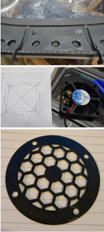

Glare Shield Fan Grill
The RV7/9 tip-ups leave very little room for "defrost" fans. I chose to use 50x50x20mm computer fans to fit into the small space available (much more airflow with the 20mm deep fans vs 10mm deep). I didn't like any of the off-the-shelf fan covers, so printed my own instead. These are made for...
