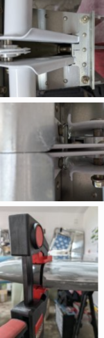

Build Update; PaulvS RV-6
Today I'm down in the detail of fitting the ailerons and flaps to the wings and have encountered some interference between the aileron pushrod and the flap skin leading edge. There is no mention of this issue on the plans, but it seems inevitable.
