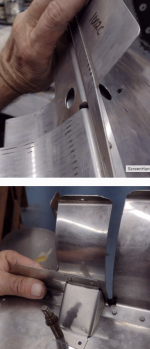

….from last weekend’s what did you do thread.
A way to mod #2 existing baffle
…DanH
“… Just two holes, and add the duct...done”
…DanH
Baffle Mod
I went with a mini-duct per a later DanH post ..it was easy to make and gives more cross sectional area for the air to get through. YMMV, but my #3 has no cooling issues. I did a similar thing on the front of #2, tucked behind the IO-360 snorkel. The only cooling mod I had to do after...
