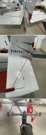

rag’s DIY Heavy Duty Rudder/Elev/Tailwheel Gust Lock
I run loose cables to the rudder which allows it to bounce around in the wind or someone's prop wash. A few years ago the plane was caught in a nasty sand storm (tied down), which really beat up my airplane and pitted the plexi. I designed a heavy duty gust lock system to hold the rudder and the elevators, no matter which direction the wind was coming from. I also have a light duty gust lock for the rudder if I am only leaving the airplane for a short time in calm winds.

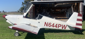

Zero Time RV 6 for sale
In August of 2023 I completed N644PW and was issued the Special Airworthiness Certificate and granted the 40 hour test program (and area) I had requested. Shortly afterward, I received the Repairman's certificate for this airplane ( Sept 20, 2023 certificate # 4898239) which I had requested as...

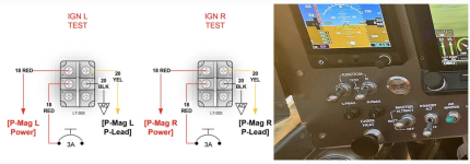

P-Mag Switchology How Did You Do It? What You Think of My 3 Ideas?
So all P-Mag drivers know there is power, P-lead. Assume x2 P-Mags, to test you ground one P-Mag P-Lead and on opposite P-Mag you turn the power off to test self-power function. Question is how to do. What did you do? Would you do it different next time. #1) Two power (toggle) switches and one...
