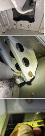

….elevator stop update
I may have reached the "if in doubt, call Vans" stage of this, but I wanted to follow-up with some measurements, referencing the annotated photo below.
These dimensions are difficult to measure accurately because a caliper does not fit with the elevator horn.
A = 0.84" (this is the most precise of the measurements)
B = ~1.0" (slightly less than 1" as described)
C = ~0.69"
My impression is that C is hogged out more and the contact occurs primarily on A, but I didn't have any modeling clay handy to check it. As you can see from the second picture, the elevator horn does not come too close to contacting the bulkhead in its present condition. Do you think more material removal at A, or A&C is allowable?
C = ~0.69"
