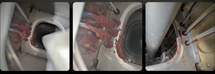

I've been slowly converting the RV7a I bought from here to be a good IFR machine. Next up, Pitot Heat.
I have a Dynon Pitot Tube with AoA and I decided to start poking around to T-shirt size my next project and to my surprise when I opened to access hole I found quite a lump of goop on the fittings. I was hoping this would be a "quick" swap out and re-use the old fittings, but now it's looking like a lot of goop to clean and hope I can still reuse the ones here. I think the goop is some fire resistant Permatex.
What's the reason for having it over the fittings? Is this potentially...

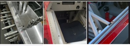

Instructions state I’m to align 816, Cockpit Rail so that it’s flush against the upper longeron.
As you can see in the pictures, it’s about a 1/16th from the edge at the spar junction point, and no ability to move or adjust at this point.
As it moves to the ends, both forward and back, it tapers nicely to align right on the edge.
Is this as expected?
Do I squeeze / clamp where I can to minimize the gap, or eliminate the gap, and don’t worry about the 1/16th at the 804 bulkhead junction?
Jw
