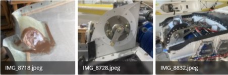

Upper cowl pic ...Desert Rat
It seemed to me that I could do better than the hole full of scrap foam idea, so instead of the stair step cutout, I cut out out more of the ramp and then laid in some fiberglass to make a concave transition in that area. I then modified the baffling over the governor to mate up with it.
I don't foresee any problems with this but I'm not flying yet so we shall see.
