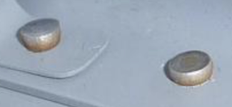

solid rivet shop head should be barrel shaped, not corked shaped
For those who may not know… a solid rivet shop head should be barrel shaped, not cork shaped. BTW I did not find this in Section 5. Too many blows with insufficient force will result in a cork shaped shop head that has been work hardened, further forming will likely crack the shop head. I...
