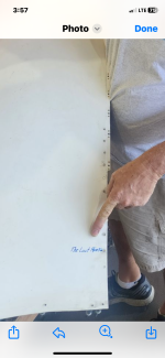

A milestone was reached today. I had to fix a droopy wing tip trailing edge and realized the last rivet was upon me.
Everything is now in place and tomorrow will be the first flight.
Final W&B came in today at 1170. My test pilot will need a case of water in the back. Fat boy won’t need since I outweigh him by 70lbs.
