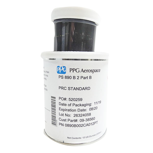

Does someone make one like a calk gun? I have the two parts in a can version vs the tube version.

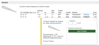

The Semco style sealant guns are worth every penny !Brown tool has a good selection of sealant tools if you are looking to make a luxury tool investment.
I like icing/piping bags better than zip-locks.
Yep. Slip the syringe into a caulk gun for extra leverage. Works great.These work pretty good
Another vote for the SEMCO sealant gun. It just works so well, keeps mess to a minimum, easy to clean up after, puts out a nice consistent bead ... I don't recall how much they are, but I don't think they are that expensive.
