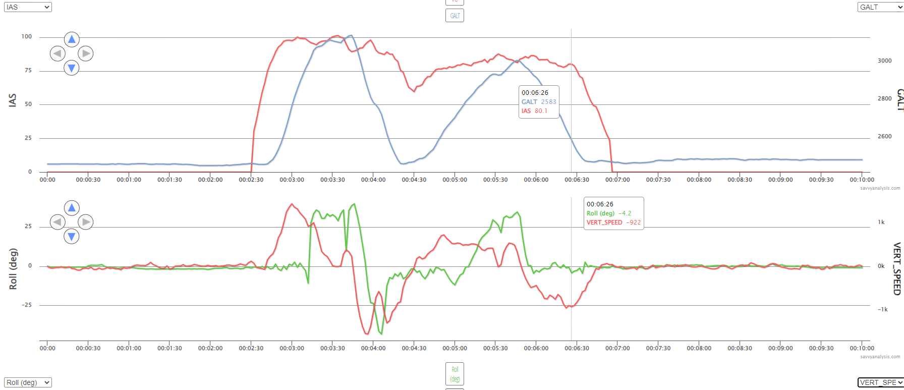

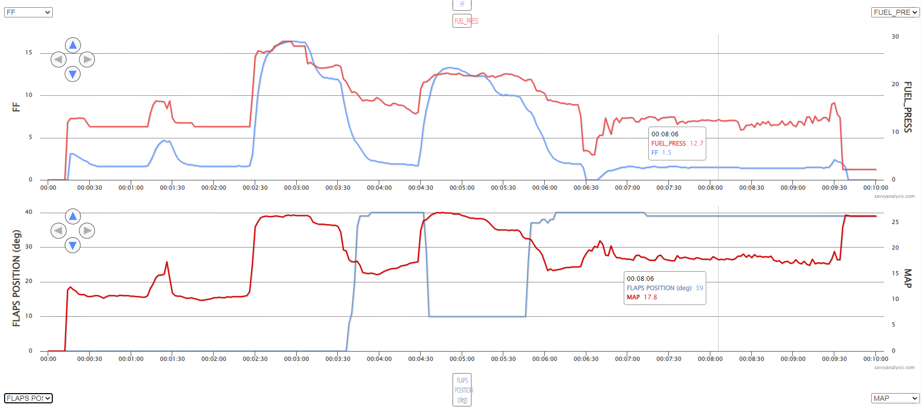

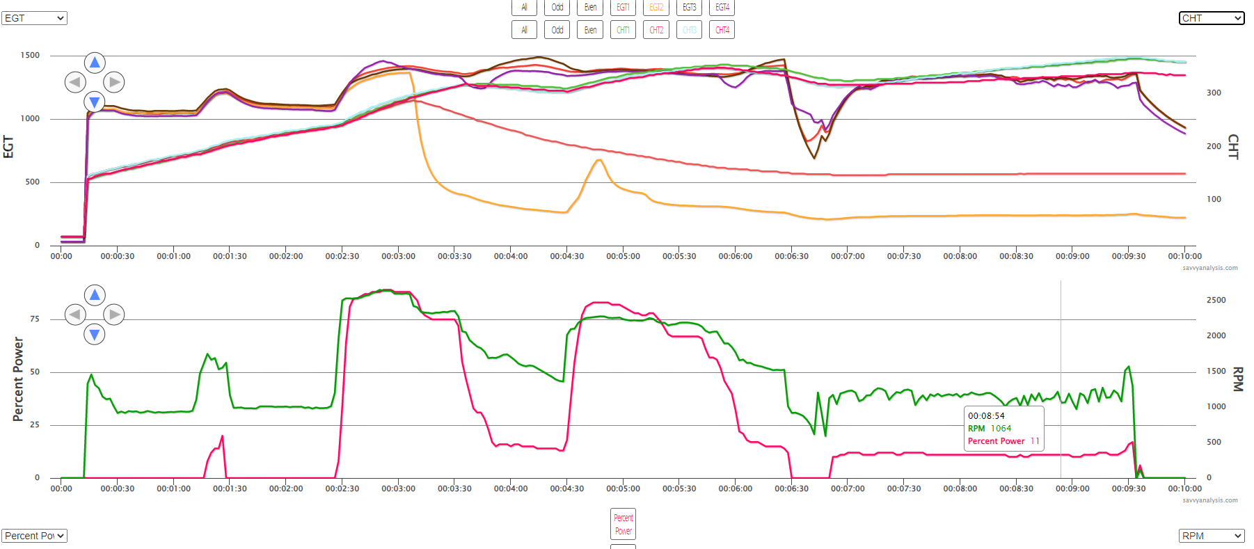

Here are the datas from the Skyview datalog:
The whole flight lasted four minutes. You can see this in the timelines from 02:30 to 06:30.
Note the RPM decrease at 06:30 when I pulled the mixture. The fuel flow went to zero while the RPM dropped from 1500 to 1100 RPM (windmilling).

Based upon the FP data, assume you have FI. Fuel flow is based upon airflow through the servo, so having 1 stuck Exh valve should have reduced fuel flow. It is possible that you were too rich and this reduction in flow leaned things up a bit which would increase power a bit if it moved you from excessively rich to best power.

I´m having an ECI fuel injection system, this controls the fuel flow not according airflow but according the position of the throttle plate. Well - it is kind of dependent of airflow in this regard. But the actual fuel flow is controlled mechanically.

If you look at your EGTs right after start, there are running steady at 1100 F-ish. I would say steady.
At 03:15 #2 “departs”.
After landing, around 06:45, your engine is running as stated above with EGTs around 1300-1350 F-ish. Same fuelflow as upon initial startup, higher RPM (more air), engine is running leaner than upon initial start, therefore higher EGT on the remaining cylinders.
Higher RPM, higher MAP.
Your engine doesn’t run more efficient or anything in this direction, most probably producing less torque and overall-power-output.
But, In a low speed, steady-state environment, those are probably the results that we see……at least to my understanding.

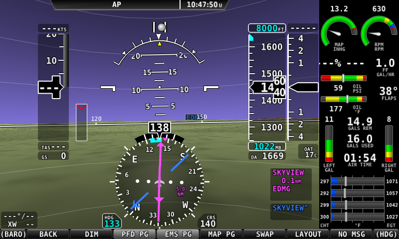

So after a flight today just before shutdown I pulled the throttle all the way out to the mechanical stop, mixture full rich: MAP 13.2 / RPM 630 / EGT around 1050 F.
Then I removed the cowl and the #2 spark plugs to simulate the open exhaust valve, then started the engine again and saw following datas with throttle all the way back again and mixture full rich: MAP 17.0 / RPM 1150 / EGTs around 1000 F except #2. Both tests are done stationary, so no forward speed.
This looks like proof that the engine is in fact producing some power or thrust with idle power and throttle closed with one exhaust valve stuck open. The only difference during this test was cylinder #2 breathing through the spark plug holes instead through the exhaust valve, so this takes out the influence of the exhaust. I think this is a representative test and confirms the original data.
Just one more info in case somebody is wondering: Yes I did ground the removed spark plugs to protect the ignition modules of the Pmags.

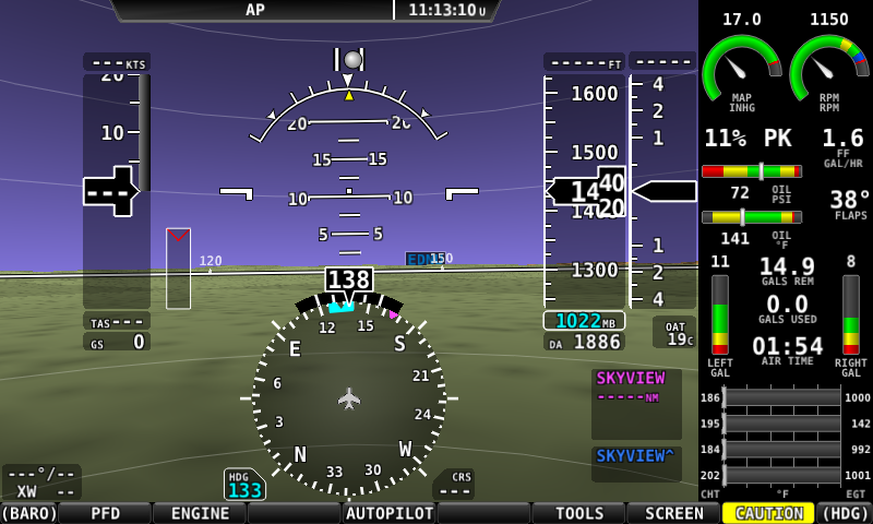

Here are the screenshots:
Throttle fully closed, mixture full rich
Throtle fully closed, mixture full rich, #2 spark plugs removed
