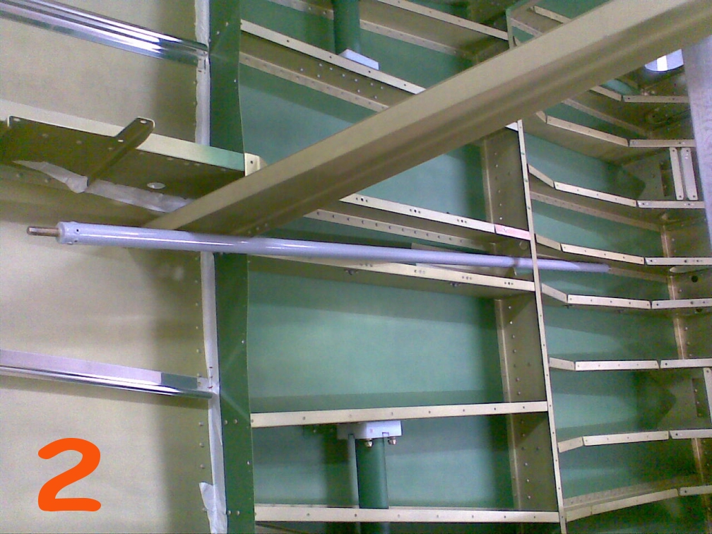

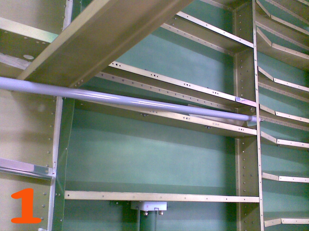

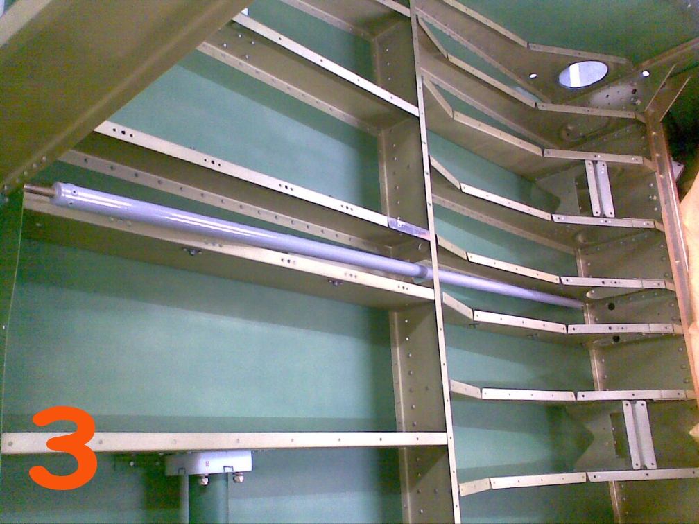

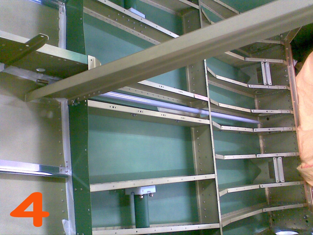

Step by Step
Hello Bob
here are my pictures. Sorry about the quality, I made them with the mobil phone.
I made my tube by 1/8" longer, I like to see a few threads more engaged, so I was really alarmed when I have seen your first post!
* I slided the tube in from the back to the front
* on the right side, along the bellcrank channel F-728
* throu the rear spar bulkhead F-705 bulkhead, untill it hit the main spar web,
* then back throu the bulkhead F-706B until it sits on the correct position.
I hope all is fine with my controll tube, because I can really put it in with 2 fingers!? So please check my methode and report, so that I can go relaxed to bed :rolleyes: and not have to fight against bad dreams (:-)

Dominick,
You have provided a great end to this post. Your pictures say it all. I just didn't think outside the box...literally, it just didn't occur to me to go outside the center support at the bellcrank bulkhead. There is a couple more inches between the 706 bulkhead and the main spar than between the 707 bulkhead and the 705 bulkhead. Even though I have already "flexed" mine in, I think I'll take it out, paint the scratches and PUT IT IN RIGHT. Sleep well.
