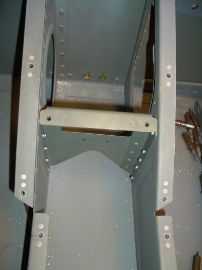

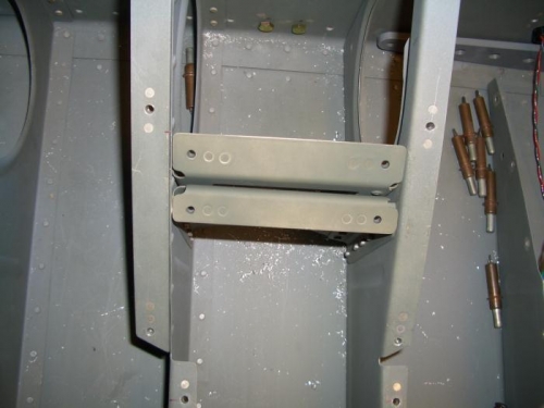

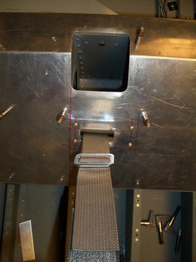

Colin,
How did you secure the centerstrap? Pics would be awesome!
Colin,
I used the VANs 5th point kit for the RV-7, but cut off one side of the brackets and replaced it with a piece of angle so I could adjust the width. I also replaced all the belt ends from crow with standard triangular ends since they are shorter.
