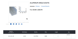

I don’t know why I have consistently lost spatial perspective with these parts. It is too easy to blame the plans and, of course, I don’t think I am the problem. In any case I need some new AA6-125x3/4x3/4. I might be able to source this locally if I can figure out what this angle is. Is there a secret decoder ring for the Vans material?
Is AA6 6061-T6?
Just make sure any angle you get has the radius at the inside corner vs the hard 90* angle like you'd see with angle from the big box stores.
Is AA6 6061-T6?
YES!
Is AA6 6061-T6?
I think this is what you need (From Aircraft Spruce)

An update: ACS will ship a single $20 6061-T6 .125 3/4x3/4 10’ long from GA to FL for $265.00. Ummm. I am going to go another way.
Find a local metal company. They can order along with regular shipments from their warehouse and you will have leftover which comes in very handy. And you will avoid shipping charges.
I will do a local search. Does only aviation use 6061-T6?
