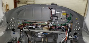

I am building an RV8 and need input for placement of the main and avionics buss bars and grounding pins. Attached are a couple of photos where I think they could be mounted. Looks like the strut connecting the two gear towers could work - close to the breakers and the strut could support wire bundles. I do have the hinged avionics bay access door. Also attached is a photo of the panel so you can visualize avionics and back-up instruments protruding into the bay. Any critique or alternate ideas appreciated. Thanks.

I mounted the busses on the inside of the door facing the avionics compartment. I made a tray across the crossmembers to mount the radio remote, EFIS BU battery, ground buss etc. Worked out ok.

Not a fan of live bus bars facing up. Facing down means nothing can ever drop on them. And yes, using fuse blocks eliminates them entirely. Mine swing down.

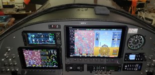

dmatre,
If you move your breakers and switches to the side wings and the arm rest, you greatly simplify maintenance, upgrades and modifications as removing the center panel to work it on the bench is a simple 15 minute task.
No need for shelves, access holes to the baggage compartment and such.
Side note. I never use copper buss bars. I know Cessnas and such use them but for me they just seem alike an accident waiting to happen.
Carl

dmatre,
Carl

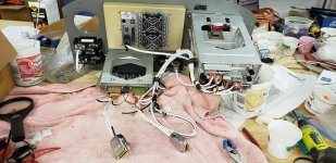

Yep - but not as much access as you would think. Assuming you have other stuff in the panel (GPS navigator, comm, audio panel and such) this access does little to help with trays. The trays tend to be the biggest issue.
As I’ve posted in the past, the rule is “never on your back with your head under the panel”.
Carl
Photos of the center panel in and out of the plane.
Carl
