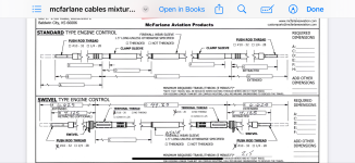

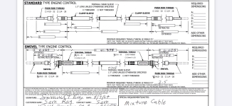

Dimensions for custom McFarlane cables
OK, here is how I order McFarlane cables.
The example dimensions here are for a 60" total length cable.
Download the form from the McFarlane website. https://www.mcfarlaneaviation.com/section/services/custom-engine-controls/
Click on the quadrant type cables text to download the .PDF
Fill out the section for the Swivel Type Engine Control
Dimensions
A: 6.5" Extended
B: 4.25" Retracted
C: n/a you don't need a firewall wear sleeve
D: 49.25"
E: 6.5"
F: 4.25"
Note that 6.5 + 4.25 + 49.25 = 60. So one end extended plus one end retracted, plus the length of the sheath equals the total length. Adjust dimension D for other length cables.
Mark 10-32 pushrod threads both ends and 7/16-20 terminal threads both ends.
And honestly, I think it wouldn't hurt to get a little more travel - it will make it easier to get everything adjusted for full travel. So you could do
A=6.5
B=4.125
D=49.375
E =6.5
F =4.125
Hope that helps lots of people to never have to change their cables again aftward.

Steve - Thank you for the measurements and your tips on how to change the cable. Just to make sure I understand it correctly. The measurements above are based on the CT Q-60 with the top measurement being the cable with the original travel and the measurements below that with the slightly extended 2 1/4" travel? Is there anything to be aware of with the slightly extended travel? Could it have any impact on anything else? O and I guess, I would have to go for the swivel type engine control? Better ask before I order.
I have got a fuel inject Mattituck IO-360 on my RV8.
On a different note, I contacted McFarlane to see if they had the measurements for the CT Q-60 already as I would imagine that they get more clients ordering replacements. I don't really want to remove my existing cable to get their required measurements. They said the couldn't help. I am surprised. I told them it might be worth for them to buy some Van's standard cables, so they can serve clients like myself a bit better. Maybe even keep some replacements in stock. They charge enough. Anyhow, that is by the side. ;)
Rogier

IO-360-M1B with Van's recommended firewall penetrations. I also have McFarlane mixture and prop cables drawings if you want them too.
Looking at your total length being 52in I take it you did that to reduce the slack that you have with the vans 55in cable? I did notice my 55 does have some extra slack that isn’t necessary.
The Vans mixture cable extra length was taken up firewall aft- that compression was focused at the firewall eyeball grommet which eventually eroded the cable sheathing. My cable throw is longer than the Vans throw which makes centering the lever in the cockpit easier.
The photo shows no puckering of any cable.

Hi Sam or any experts,
I've got an IO-360-A1B6 motor. Would that McFarland mixture cable dimensions in the drawing you posted work for mine?? I'm using the 3-handle Formation Quadrant from DJM. Thanks!
