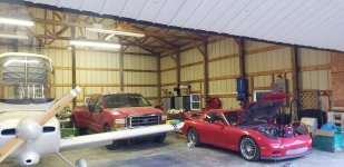

I purchased an RV-7A the end of Sept. and then took 30 days to meet insurance requirements, but finally got it home. I then spent the next month making it airworthy (brakes, tires, oil, etc.), and have now finally begun getting to know it a bit. Since I've been building a 9A with a 13B since 1999 (#90116), it's nice to have this 7A rotary to fly, while I finish building the 9A! Empty weight: 1107 lbs., est. HP 180, Prop: Cato 76X88, Total Time: 928 hrs., PSRU: Tracy Crook's "C" model w/2.85 ratio, fuel: 87 oct. auto fuel with 1.5 ounces of marvel mystery and 1.5 ounces 2 cycle oil added per 5 gallons of fuel. Cruises 175 TAS at 7-8K, and est. 8.5-9.5 gph. As I fly it more, I'll be able to get some updated numbers.

I now have flown the Renesis powered RV-7A I purchased last Sept for about 13.5 hrs. with a 4.0 logged yesterday. Over the 4.0 hrs. I burned an avg. of 8.5 gph while cruising about 160 mph TAS, at 5500 ft. Thus far the engine fires up every time after only turning 1-1.5 blades, whether hot or cold. The oil is running a higher than I'd like in climb out (@210 degrees), but it drops down to 185 degrees while cruising. I still am going to experiment by adding a "shark" like air exits on the oil cooler side of the cowling, or possible add a turning vane to the intake to pull some more air from the water radiator side, since water runs cool at 145 degrees on a regular basis.

I've been flying the RV-7A fairly regularly since January and finally hit 50 hrs. on the hobbs meter, and therefore pulled the cowling off and drained the Mobile One oil. The Renesis 13B lost/burned zero (0) oil over the last 50 hrs., and visual of everything under "the hood" looked pretty good, and no worse for wear owing to the 963 hrs. now on this installation.
Since the cowling was off I also did a compression test on both rotors which yielded 88 95 89 (#1), and 89 92 91 (#2), and as a rule of thumb (on rotaries), 80+ PSI shows the engine is still pretty tight and producing good HP.
