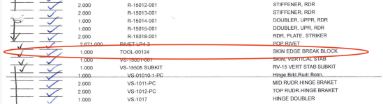

LE skins are primed on the inside. I have yet to figure out how to break the long edges due to interference from the dimpled holes. A guy at the airport has a large brake, we may explore how to do this. Any ideas are appreciated!
I’ve thought about ordering two more of these and asking them not to dimple them. I’d like to have a couple replacements anyway and I could use the ones I already have as spares.
Another option is 3D printing a round, beveled edge piece that would fit under the dimple, then use a rubber mallet to create the break around it. If you did the normal full width break between the dimples, then blend that in with the narrower break from that 3D piece, it might look ok.
Let me know if they are willing to sell LE without dimples pls.
I used the standard edge break roller tool but obviously the dimples interfere with the rollers. As part of the empennage kit Vans shipped a "skin edge break block" and I followed the guidance in section 5.10. I cut a groove in the middle of one of the edges of the block in the band saw and used it to bend those trailing edges at every dimple location. It doesn't look pretty in the picture as you can see the wave in the skin but you can see that when it's installed the skin lays flush along the screw line.
They are "unable to produce custom fabricated parts."
Seems like one of the companies that makes fiberglass parts has an opportunity here? I may play around with making a mold. Should have plenty of time before the fuselage kit arrives ;).
Finally decided to roll the edges with my existing tool, and leave the areas around the screws untouched. I'm not sure if this is the right answer as the LE parts haven't been painted and mounted, but overall it looks ok IMO.
