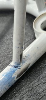

I have two factory built RV12s the the 912ULS engine. One engine has about 900 hours on it. The other has close to 1600. On the last inspection I found a crack on the 900 hour engine mount. It was on the left side tube just below the upper engine support arm. Its difficult to tell from the pictures, but the crack wrapped around the tube about 230 degrees and travels back and up around the tube, with the lowest point of the crack being on the front side of the mount. Now, I have found another crack on the higher time engine mount. It was spotted while the bottom cowling was off and has formed within the last 50 hours (this mount was checked 50 hours ago in this exact spot by myself and a second mechanic). This crack is in a similar area, located on the left side tube, but on the bottom engine support arm.
I have seen one other similar crack on this forum from sometime last year. I am wondering if anyone else has experienced cracks like this. Having two aircraft at vastly different engine times experience similar cracks within 100 hours of each other is concerning. If anyone has any suggestions or experience with these cracks, I would appreciate it. I am concerned this is only a symptom of a bigger problem and not the actual issue. That being said, both of these cracks are near heat effected areas of welds, so it could just be poor heat treatment.
Declan
Can you share pics from farther back maybe with an arrow or circle to help us know exactly where you are finding these?
I have reported on cracks in two different 912ULS RV-12 engine mounts. The mount on my airplane had a cracked tube at lower left engine attach fitting. It was repaired with 4140 welded over-sleave. The second engine mount had crack in rear ring on right side near oil tank. It also was repaired with 4140 welded over-sleave. I know of one other RV-12 mount that had same crack on rear ring right side....

Will unfortunately as I was just starting my condition inspection I have also found a crack in my motor mount. 2011 with 1057 hrs. Gearbox rebuilt by Lockwood, prop always balanced and carbs. always synced. Crack was on the right (passenger side) side main frame tube just above the where the small tube is welded that goes to the engine. I guess having gusseted and welded is the only option. New one was listed last at about $1,900 and who knows when available. I’ve been making sure to really inspect after all the SB’s (front leg, stand off and Piper J3 and others post )Now to get it all off and more importantly to find someone qualified to weld it. Any advice appreciated.

The engine mount part number, WD-1220, is the same for the ULS and iS engines. Does anyone know if there were changes made to prevent cracking, e.g. different materials or heat treatment? Have more recent mounts also cracked?
It looks like you're not too far from me, bring it up and spend a couple hours and I'll send you home with it repaired.
It looks like crack is sufficiently in the straight section of tube, so a split over-sleeve should work. Need correct filler rod and welding technique to relief stress. Very doable. Look at photos above in post #4. Russ McCutcheon is nice guy... :)

Howdy there; So you replaced them with new van's aircraft engine mount parts.
With a RV12iS aircraft, you should check engine mounts every anual for cracks!

Following FAA AC 43.13-1B I repaired the crack, which was about 3/4 around added a splice of 4130 over the top.
