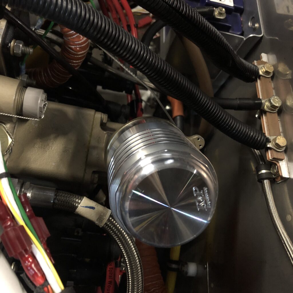

I picked up the K&P Engineering filter, it's the less expensive non-aviation version of the Challenger filter. Just installed in 2 weeks ago, so I have another 2 months before I'm due to an oil change and can comment on the cleaning.
All the review I've read and people I've talked to in person have nothing but great things to say about these filters. Easy of cleaning is a HUGE plus for me, I'd be glad to never have to cut open another filter again. The K&P version can be had for under $200 shipped, the return on the investment is quick with our throw away filters hitting $40 each and the fact they can't be found right now.

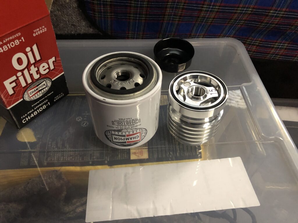

For those of you using the S15 version of the filter, I know you have to use the special tool that comes with the filter.
How does the installation and removal compare with a standard Champion/Tempest filter - specifically, the space between the firewall and filter?

Here's a side by side image of filters. The K&N is smaller and allows more room.
I don't think the tool (top in 1st picture) is anything special. You could use a strap wrench too.

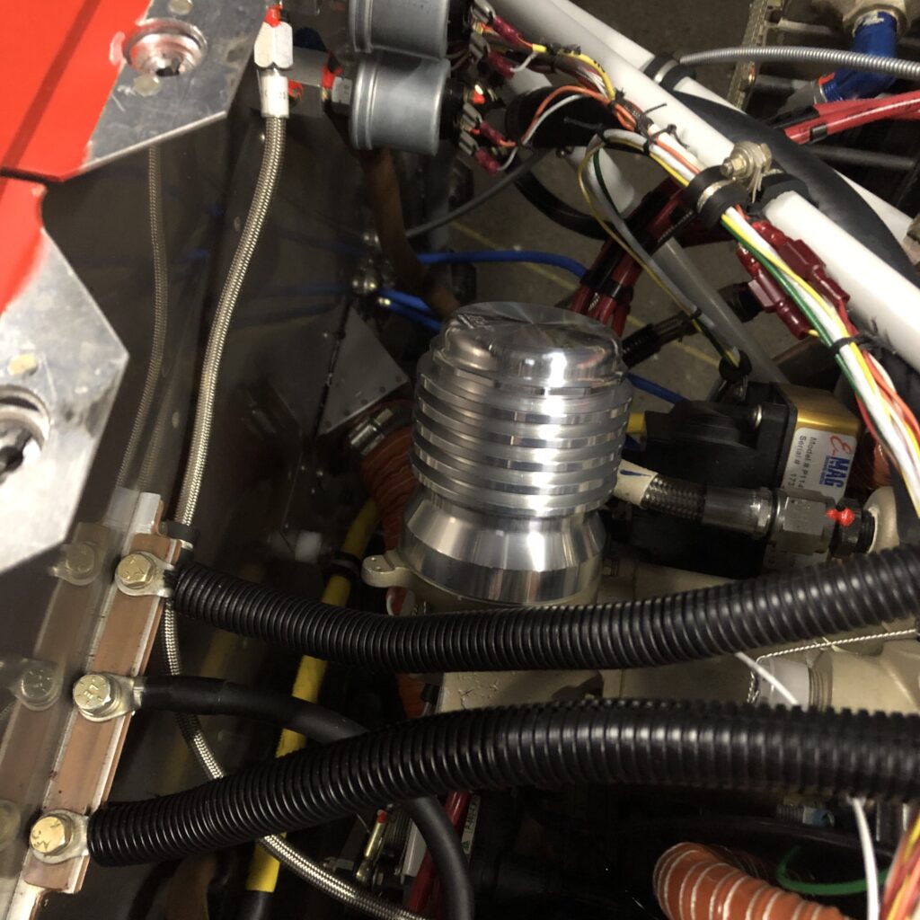

I converted to the Challenger a few years ago. Change my oil & clean the filter at 30-40 hours. Posted my recommendation way back. My filter has NEVER looked like the BMW pix above. I’ve only seen a few specs of carbon.
Bought an extra seal when I purchased the filter. Have yet to use it, after 15+ oil changes.
Mine has easily paid for itself plus. Made total sense to me back when filters were obtainable and cost $18.

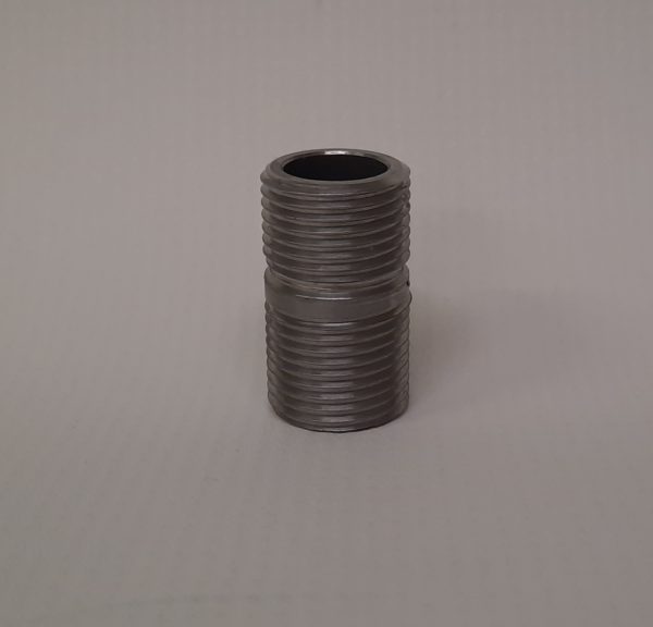

so I just ordered one for each of our Lycs (and clones….) along with two of the nipples I need for two of them.
Not to appear naïve but what "nipples" are you referring to? Photo?

It is the the 3/4×16 X 3/4×16 threaded fitting. Some oil housing may not have the thread mount so you need to add it.

compared to a CH48110-1, it is 1 1/4" shorter measuring from top of nut. The diameter is 1" narrower.

Much easier, the filter plus tool is still not as deep as the Champ, Temp filters. It's a much easier process for me. I always had a hard time with the Champ and Temp due to the clearance to my firewall. Now with the K&P, all is much more simple.
