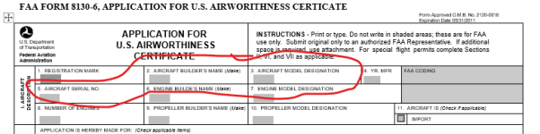

Make (ie Manufacturer ie Builder’s name)
Model (RV-7A)
Serial Number (came with the kit from Van’s. This is not the N number).
This the most often discovered discrepancy I find on airplanes, both when doing a DAR inspection or a prebuy. It is always the name. It has to be EXACTLY as on the registration. Think of how many people have names have a like-sounding first and last names, like John Paul or Ruth Chris, as examples. One person might be John Paul and another person be Paul John. Pay attention.
The other common mistake I see is builders put Vans Aircraft as the builder. This is only valid for S-LSA and E-LSA. It’s amazing to me how many have slipped through the system and have Vans listed on both the registration and the data plate as the manufacturer.
Vic
Model (RV-7A)
Serial number can be ANY number (or combination of numbers and letters) you choose when submitting the paperwork for the initial registration/AWC, as long as it is unique to that manufacturer. Mine is 001.
