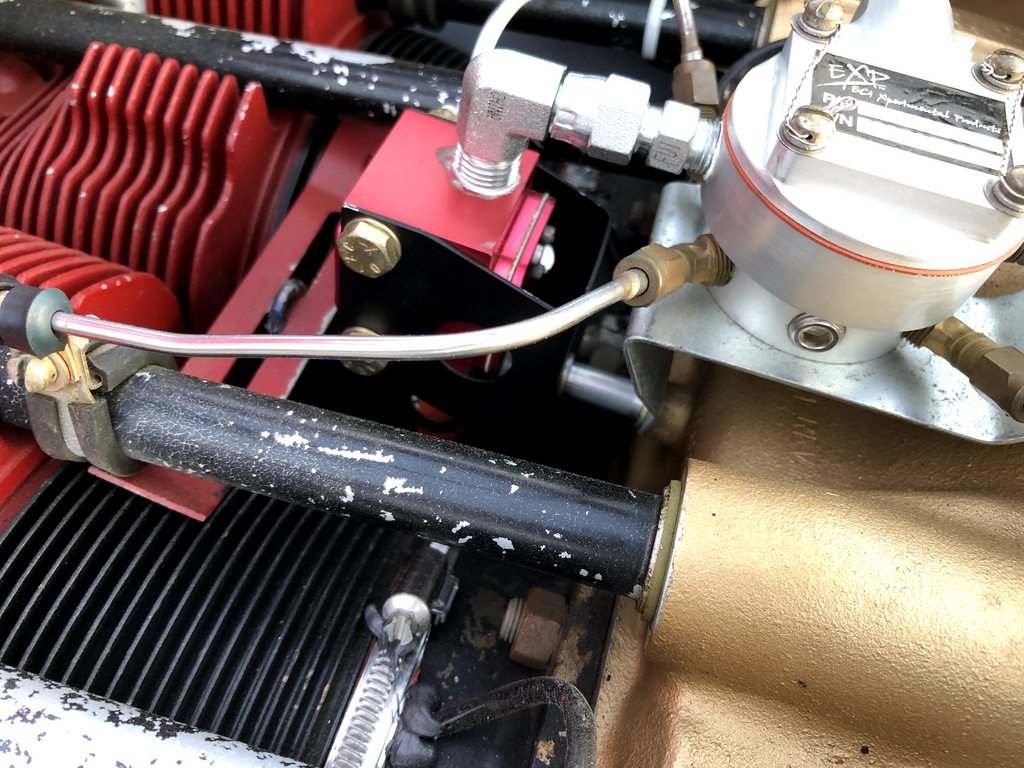

So, if you hadn’t noticed, I took a shot at a new method for mounting the red cube in my -9A with a Lycoming YIO-320-D1A with an AvStar fuel injection servo under the heading “Red Cube Install, A new look at an old challenge”, and putting it mildly, it was torn to shreds:
1.) “Adding a bunch of hose length above the engine will result in heating a bunch more fuel while parked. Engine starts after a quick turnaround could be more challenging.” (Scott McDaniels)
2.) “You now have a loop at the highest point for vapor to accumulate.” (Bob Japundza)
3.) “Just wanted to pass on another concern about penetrating the baffle with a hard line at that location. Unless well braced, that spot can be the source of significant vibration, especially if an oil cooler is hanging off the baffles.” (j-red)
4.) “This is evidence enough that there is a lot of vibration induced on this area of the baffling. Putting a hard line between the solidly mounted transducer and the baffle (which has tons of in- service evidence to be always influenced by some level of vibration) is not a good idea.” (Scott McDaniels)
5.) “I'm with Scott regarding the excessive hose length and the hard line.” and “Bob's note regarding the loop is valid. Great place to store lots of vapor.” (Dan Horton)
6.) “Clamping anything much heavier than ignition wires or spider lines to the push rod tubes is generally to be avoided. I’m not predicting anything catastrophic here, but the combined mass of the red cube, the steel bracket, and the attached lines is fairly substantial, and one end of this whole assembly appears to be supported by mid-span clamps on the tubes. The tubes are thin aluminum not intended to be structural elements, and are supported at each end by nothing more than a soft plastic washer jammed into bosses on the engine case and cylinder heads.” (Otis Holt)
I was, and remain grateful for the thoughtful feedback provided by everyone above. Thank you.

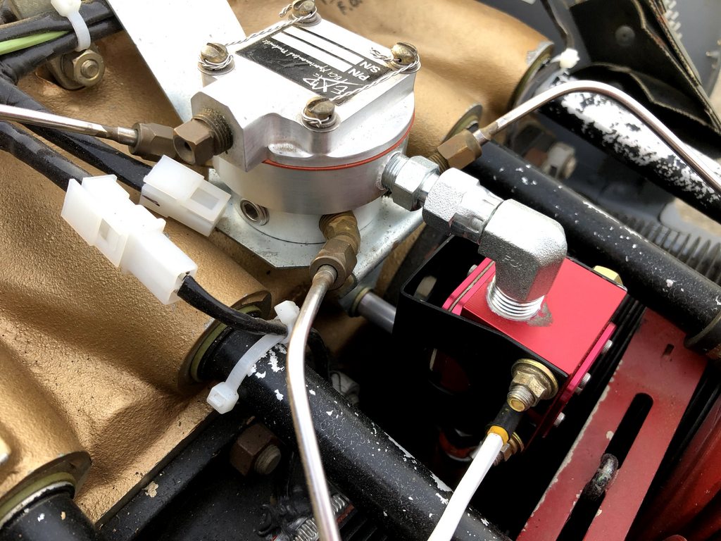

It also seems that the engine as purchased through Van’s and configured by Lycoming was somewhat out of the ordinary. It’s my fault for not questioning and fixing this right off, but like I said in my previous post, the engine install skills are my biggest weakness in this build, and I didn’t know enough to question what I received:
- The fuel distributor was mounted between the #2 and #4 cylinders, when it seems that the more common location for this is between the #1 and #3 cylinders. (BTW, all the IO-320 or IO-360 engines on display at the Lycoming booth at KOSH this year had the divider between #1 and #3).
- It also seems that the “IN” port of the distributor is normally positioned perpendicular to the centerline, where mine as positioned at a 45 degree angle to the centerline toward the aft.
This was the first thing I fixed, and it was surprisingly easy to do:

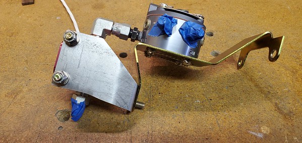

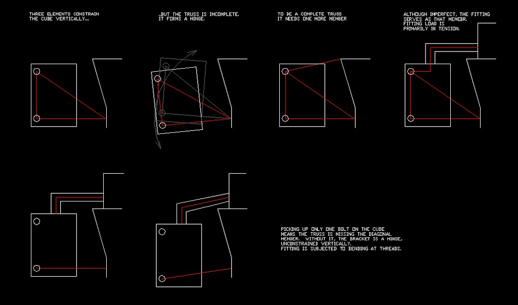

What Tom refers to as “the way we’ve been mounting them” is through the use of a stainless-steel elbow fitting with a male NPT on one end, and a female -4 AN fitting on the other which Tom supplies.

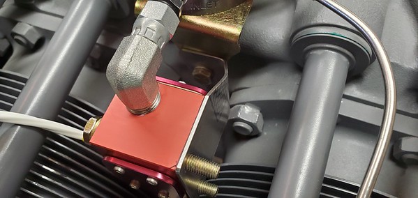

However, a well thought out way to secure the red cube to the engine (so it’s not just left hanging from Tom’s fitting did not exist, and that’s where Dan Horton comes in.
My first attempt at this bracket is shown in the next two pictures. Made from .063? 4130 steel, and again bent on my super cheap HF 18? sheet metal break. Please note that the ?-20 bolt shown holding the divider bracket (Lycoming P/N 75009) and my new bracket gets attached to the existing boss on the engine.
Upon his review, Dan had the following comments, ?The bracket is a great idea, but not really well executed.
Main issue is its asymmetry...it is one-sided. Assume a vertical load vector due to crankshaft reaction. Part of the load is reacted to the fitting and part to the bracket. Trouble is, the result is a twist, because the bracket is not symmetric to the mass. Not good for the parts, and it tries to unscrew the bolt. The cure is easy enough; a nested bracket for the opposite side (see sketch attached) or a U-shaped bracket (same as sketch, but one piece).
The sketch which Dan makes reference to above is as follows:

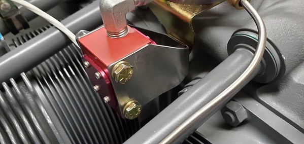

I asked Dan his thoughts about reducing the size of the bracket to aid in fore to aft airflow through the area and he felt this was a non-factor. I also asked about a much smaller bracket only utilizing the lower hole, and he offered the following advice and picture, ?Definitely need two bolts on the cube end of the bracket. The second bolt point effectively makes it a truss. Weak without it.?

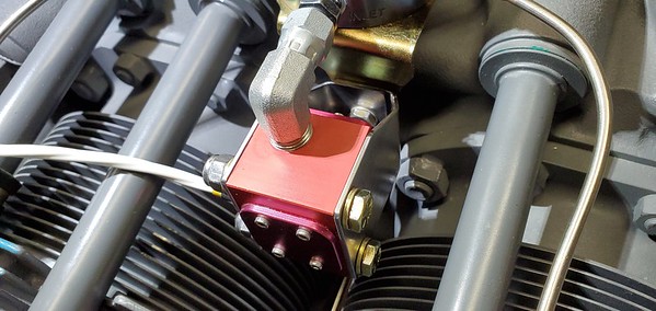

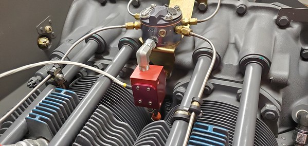

Based on this information I built upon my existing bracket and added a second piece to the aft side of the red cube and here?s where I ended up:

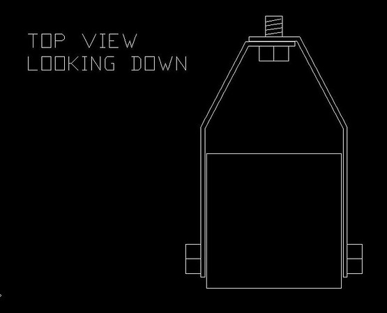

In seeking out Dan?s final approval, he offered the following, ?The attached illustrates why I think it a reasonable plan. I believe the fitting is more than adequate to serve as a tension member.
The side-view truss existed in the prior version, but as noted, it was asymmetric, and that would have subjected both the fitting and the bracket to combined bending and torsion.
If you want to build the Mother of Brackets, simply add a flat plate, sandwiched between the divider body and its bracket. The outboard ends of the plate would be welded to the top edges of your side brackets. The plate would serve as the tension member rather than the fitting. No, I don?t think it is necessary.?
Dan also supplied the following drawing:

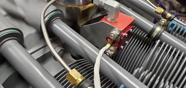

So here?s where this ends, a mounting solution for the red cube which:
1. Does not violate any of EI?s installation recommendations
2. Secures the red cube to the engine using a mechanically sound bracket which can be easily made in any builder?s garage shop with minimal tools
3. Can be completed using parts available from Tom Swearengen / TS Flightlines

Chris - wow, you are making great progress!!
You are also taking the correct approach - don't consider anything final and unchangeable. The mount you have looks great.
One thing to consider... the specs on the Red Cube say its upper temperature is 125C, which is 257F. While the cylinders can easily be in the 350F+ range at shutdown, I don't know what temperature the Cube might achieve during the cool down. Perhaps some sort of silicone rubber insulation sheet could be attached to or wrapped around some of it (McMaster aviation has it...).
I violated one of the install guidelines and mounted it in the cockpit, between the boost pump and the mechanical pump. But it has long straight runs of tubing on both the inlet and outlet sides, with a smooth large radius bend in the tube far upstream. No elbows. I find that fuel flow indication when the boost pump is on is erroneous. Common finding, but the lesser of evils in my mind at the time.
I like your install, except for the elbow immediately upon exit of the cube. This turn in the flow so close to the cube may cause an error in the fuel flow calibration. As long as it is consistent, you can calibrate it out by tweaking the K value. If the influence varies at different fuel flows, it is going to be an issue.
Have others installed this way with an elbow right at the outlet?

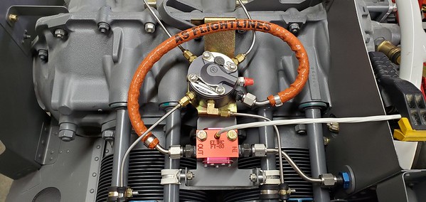

The flow divider install location of the FT60 was my idea. Several years ago, we had clients that wanted to install the transducer between the servo and the flow divider. EVERY one of them was different, 2 hoses of different lengths and configurations. Measuring the short hose was a problem---I have a BUNCH of short firesleeved hoses to prove it.
So after scrapping several hoses, I set out to come up with a generally universal location for the transducer that would work for the majority of clients. Not for everyone, but for most. During that time we tried---unsuccessfully-- to get EI to tell use their location recommendations. So we set out to test this idea. 2 airshow seasons with members of an well known show team with good results in 3 variations.
WE have a bunch of these flying around the world with no issues. The one part that did need some help was making a securing bracket that would work for that application. Dan Horton did a great job of this. Again, not for everyone, but better than it was.
To answer 1 question, Yes we are planning to make the bracket and include it in the install kit. This works IF the flow divider has the inlet port 90* to the case center line. Whether its a Bendix, Precision, Avstar,or AFP divider, it still works. If the divider has the inlet port 45* to the case, then no joy, BUT a short connecting hose can be done and utilize the same bracket. The flow divider bracket in Chris' pics is a Lycoming 75009, the most common one. In research , I found 3, all different. 2 are somewhat expensive.
Rest assured that this is NOT the only solution to the location issue of the FT60. Walt has a valid point about heat and such, but from clients flying with this, it seems this isnt a factor. (Boy I'd love to get a thermocouple in there and measure real world temps.) Texas heat anyone?
Because of the ops install, we asked Dan to come up with a bracket solution. Credit where credit is due---thats Dans bracket as fabricated by Chris. Thanks Dan for the consult and ideas!
Replacing the steel elbow and nipple? No you can't; in this example the fittings are structural. To re-route the inlet to the flow divider, you'll need the plate I mentioned, re Mother of Brackets.
