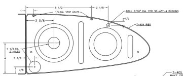

This is for the benefit of those who didn't built the fuel tanks on their plane, and may still be trying to picture what the heck is going on with a "slow to fill" fuel tank. The drawing attached shows the fuel tank rib call out for the fuel tank center ribs on a -6/6A. Other models have to have similar features, if not the same.
There are 5 holes called out that have to be machined into the center bay ribs on the tanks. (Again, I'm talking about a -6/6A here. These holes may be already punched on the latest kits or kit designs, I don't know.)
  • (2x) 1 1/2" diameter holes: These allow fuel to move between fuel tank bays during fill up and in flight.
  • (2x) 1/4" diameter holes: These allow air to vent out from bay to bay, and ultimately out the fill opening, as the tank is filled. They also allow air to move back in from bay to bay as fuel is used in flight.
  • 7/16" diameter hole: Used to install a snap bushing and 1/4" vent line. This allows the tank to vent to atmosphere when in flight. Once the snap bushing and 1/4" line are installed, very little fuel or air will get through that hole.
  • Note: the two sets of larger diameter concentric circles and the two vertical ovals shown on the rib are raised embossed areas to stiffen the rib web....they are NOT additional holes in the rib. Also, the two very small unlabeled holes shown are tooling holes used during factory rib forming.
If the (2x) 1/4" vent holes are missing, or completely plugged up with tank sealant, the air coming out of the tank during fill has no where to escape once the fuel gets above the top 1 1/2" hole. If these two holes are partly plugged up, it may take longer to vent the air out than if they were completely clear. Air may also pass through the triangular shaped corner relief area at the top left end of the rib....but that may be a smaller area than the two 1/4" holes.
Edit: Very likely this area gets filled in with sealant during construction...DO NOT bet on them providing any air venting.
Restricted area = slower to vent air out during fill up.
A borescope is the only way to tell what is going on inside a "slow to vent" tank. If the two 1/4" holes are missing or compromised, opening the tank and drilling them out is the only fix. 😧 Or, just live with it by slowly filling the tank and/or waiting for the air to vent out. 😲

Picture of a 7 tank rib during construction.
The vent line goes through the blue hole (with a snap bushing), the 2 red holes are the holes discussed above for air flow through the tank.
and those holes are close to the ribs edge, so easy to fill them with sealant when making the fillet if not carefull. I have seen them blocked before on tank reseal jobs I did.
Air may also pass through the triangular shaped corner relief area at the top left end of the rib....but that may be a smaller area than the two 1/4" holes. Restricted area = slower to vent air out during fill up.
that top corner area is typically filled with sealant, as you need a good sized bead there when installing the rear baffle. The bottom corner area is bigger and not likely filled, but that dsoesn't help with air.
True about them very likely being filled in with sealant. I would not bet on them being there after installing the back baffle.
