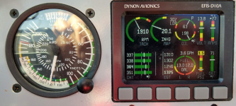

You can nearly replicate RV-12 fuel efficiency at RV-12 speeds in an RV-6 with appropriate leaning.
I think the fuel flow was probably closer to 4 gph. I usually run 60% power at a bit under 8 gph.
Dang! That’s great. What engine/power setting was that when you took the photo?
Info is in his signature at the bottom of the post.
I have an RV-6A with an O-360 as well, but with a fixed pitch prop, and can match those performance numbers but for local flying I do a little faster... about 140 at 5.5 GPH or so.
It's an O-360. Besides the RPM, MAP, % power, and FF pictured, what are you curious about?
Like Scott, I normally fly faster when I'm going somewhere (!55 KTAS - 60% power - maybe 7.8 gph when I'm in no particular rush). I fly around 120 KIAS when I might have to dodge pelicans or other aircraft while nearing the traffic pattern. It's comforting to know that I can bury the stick in an evasive maneuver without a thought to overstressing the RV.
