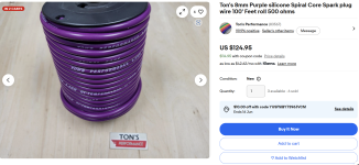

These ohmed out to exactly 500 and worked well. (And lots to use in the next 5 year condition inspection)

Buy the 45 or 90 Deg ends and crimp on. Not much else needed to complete. 8.5 mm should also work ok. (with 8.5 mm wire) Good luck !
(4) pack 45 Degree Spark Plug Wire Boots With Terminals Taylor Wire 8mm DIY kit
