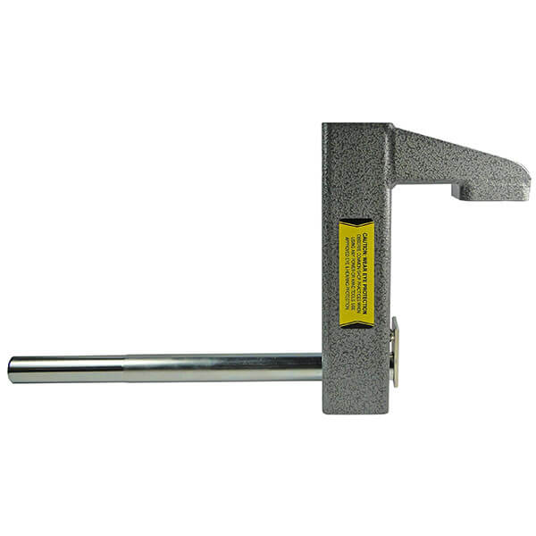

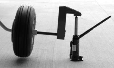

I jack up a single side maingear leg at a time with following.

I welded a 12" piece of 3/4" steel rod to an old scissor car jack and just remove the axle nut and slide it into the hollow axle. It is long enough for me to slide the wheel out onto the steel rod and then I lower the axle down onto a block of wood with a groove cut into it to hold the axle. Very, very stable and low to the ground. I can do both sides and have total confidence even while getting in and out of the RV. Then, I just put the loose wheel back on the steel shaft, jack up the axle about an inch and slide the wheel back & tighten up the nut.
To keep the same bearing adjustment, I used a permanent marker to mark the nut exactly where I removed it. Can't adjust it with my little scissor jack method. I've checked it a couple times while hanging from the wing jack and it never needed adjustment.

With that said there are other ways to get a tire/wheel off for brake, tire, tube, bearing servicing. The tool can slide into axial to get at the tire/wheel/brake disk assy off.
Avery RV Jack Stand, (I do not have one, just FYI). The wing jacks are better but more involved. If all you need is to remove a tire...
