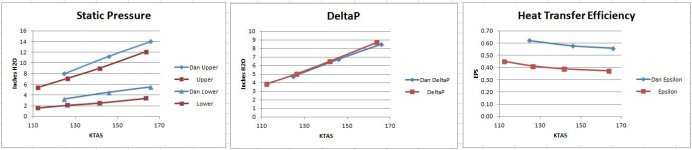

The way the engine cowls suck matter more than how they are force fed. Also remember that 60+% of the air that comes in the front goes back out near the spinner and over the windscreen, not through the engine. So the better you get the suck the better the cooling. How do you get that? Get the lower deck sucking and keep the high pressure above and not sneaking around.
David, all flow is based on pressure differential, so yes, you can increase mass flow by lowering the static pressure behind the cowl exit (increase the suck, as you would put it). However, it is a huge source of drag. It's not a good way to design a cooling system.
What you really want to do is increase static pressure in the upper plenum, then shrink the exit, throttling flow to adjust deltaP (pressure drop across the engine ) to the level necessary to cool the installation.
Below, real numbers from real airplanes...a modified RV-8 vs a stock RV-8. Higher upper pressure allows a throttled exit, so the two have the same deltaP across the engine...but the throttled exit has both a higher exit velocity and less frontal area, thus less drag. To make it cool better, increase heat transfer from the hot parts to the air, and for sure, allow no leaks which bypass the hot parts.
Several folks have mentioned adding a few washers to space out the rear baffle wall at #3. Yeah, that works, but again, it's old school dumb, because it also makes a big leak at the outboard aft side where there are no fins, as well as along the sides of the lower fin wrap. The current art inserts a small bypass duct to transfer air to the lower fins without the extra leaks. I'll bet we've seen posts with a dozen ways to do the duct.
