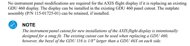

Look at the introductory material when they announced this, but I believe it is the same height exactly top and bottom but an 8th inch wider on each side so a quarter inch wider in totalI have a question on GDU 80Px, from what I gather it has the same cutout and mounting holes as the GDU470.
Is the bezel overhang from the panel cutout the same as the GDU470
Just curious as I have cut my panel for a GDU470 but will now be fitting a GDU 80Px
