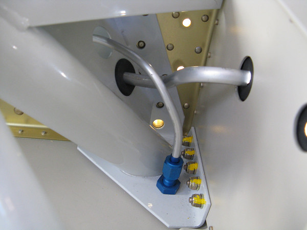

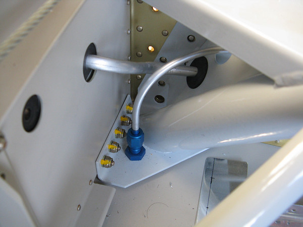

OK, ran the fuel lines.
Left side - perfect. Right side there's a little kink where it exits the fuselage. Thoughts?
No go on the kink....
There is little to no relative movement between those joints. The bends in the line will take care of any expansion/contraction if any, but you need to lose the kink I am afraid.
Darn - I was SOOOOOOO close
Definitely need to redo the line Tom. Need some aluminum? Come to Princeton I have couple rolls of Tony's stock. He knew he would need a lot... :)
Replaced
Thanks, I feel better now... and I still have enough fuel line to get from the valve to the fuel pump.
Thanks!
Thanks Vlad - I think I'll have enough but I need to come for a visit anyway.
At least you now have a good template for version 2.0! :D
Getting around the gear weldments is such a pain. I used some spring tubing benders and some lube to get around them.
Be sure to thread the tubing through the lightening hole in the weldment and use a rubber grommet in there along with the one on the fuselage skin.
Yep
Thanks Bruce. The line has been replaced and I've used the rubber grommets in both the gear weldment and fuselage exit as you mentioned.
