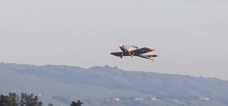

All ground run checks were in the green, so I taxied out to the runway for a beautiful, calm normal takeoff. Climb out at 2700 RPM making full power, fuel flow perfect at 15GPH, fuel and oil pressure all in the green.
About 800 ft up I some strong engine stuttering, ground observers said black smoke from the exhaust. No change to oil or fuel pressure, but fuel flow dropped to about 8GPH, RPM down to 1700 or so, and EGTs on 1, 2, 3, all dropped to from ~1450 down to 850. #4 stayed high at ~1300 (down from 1500). #3 eventually got down to 500F before reducing power to idle.

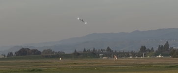

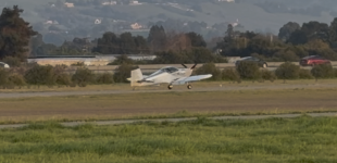

I immediately looked at my speed (105KIAS) and altitude (900ft agl) and decided to do the impossible turn. I made a slight right turn and let my speed come down to 70KIAS before bringing the nose back down to hit 75KIAS. Because I was still making partial power (~40%) I knew I would make the field, but when I brought throttle back to idle my RPM was still sitting at about 1500 (maybe this is related, but unsure). I got over the numbers at 72KIAS, and wasn't seeing it bleed off, so I pulled the mixture to idle-cutoff and did my best tail low wheel landing about 1/3rd of the way down the runway.
The funny thing about making this decision was literally reading the thread on the impossible turn over the last few days. Seeing the decisions others have made and my decision to do this is something I'm sure folks will have opinions on, but for me, with the altitude and speed I had, the calm wind, and the distance to the airport, I knew I would make it. I made the turn about half a mile away from the airport.
All in all, I'm glad I can make this write up. These forums have been invaluable for me in being ready for this day. Thank you to everyone on the forums, my instructor Taylor, my wife and family for supporting me on this 10 year journey.
Flight #2 should be soon hopefully - engine investigation first.
