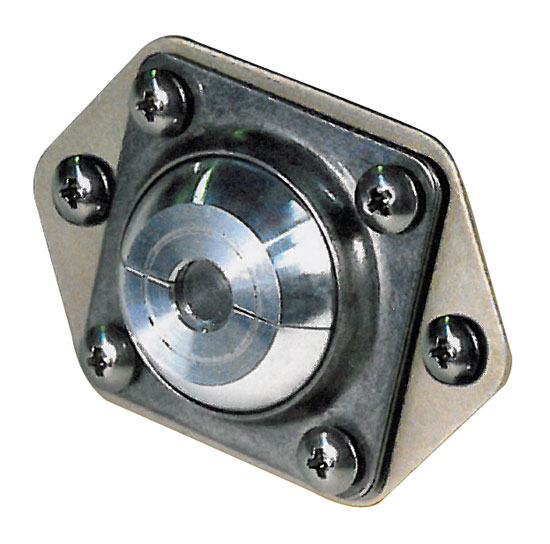

Additional examination of the
exhaust system indicated that the left exhaust pipe was a slip fit design and that no exhaust
pipe clamp was present. This evidence indicated that the source of the thermal distress event
was most likely an exhaust system leak that impinged on the oil quick drain, melting the O-
rings and resulting in the oil draining from the engine and subsequently igniting.

As a practical matter, replace the valve o-rings with Viton, or another elastomeric with even more heat resistance.

Check out the fumoto drain valves. They are a traditional steel ball valve. Have one on my 6A.
