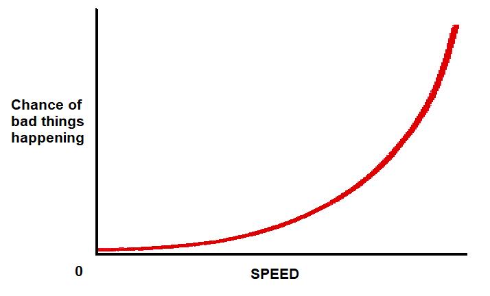

Let's sum this discussion up graphically.
No homebuilt kit, parts, or aircraft manufacturer can possibly know what any builder or pilot will do with their products. The whole point of my responses is simply to ring the bell to make folks aware that they must have realistic performance goals.
If you have the "need for speed" above all else, then you must assume the risk.
https://www.dropbox.com/scl/fi/no2f...t-45.ods?rlkey=g3faajh4eijgwdstx02wu747w&dl=0
