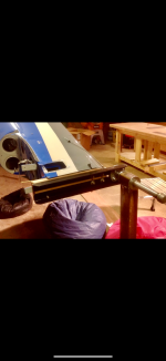

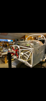

Rotisserie: I’ll add a couple more thoughts for people who are going to build a rotisserie.
I used an old drive shaft leftover from a Jeep build after tack welding the bearing cups to the yoke.
Firewall frame is just 1& 1/2” angle iron bolted together and spaced off the firewall with wood plugs cut from a 2x4 with a hole saw. Later went back and doubled up the wood plugs to space the frame further off the firewall. This extra space made room for a lot of firewall work.
After engine mount was installed I fabbed this red fixture out of 1/4” steel plate.
For the aft end I cut 2 spacers out of 3/4” oak and used more 3/4” steel angle bolted to vertical stab attach points. To allow for less than perfect alignment the tail pivot is a 3/4” pipe in a 2” square tube so it’s free to wobble.

I am curious as to how “balanced” it was rotationally when connected to the MM - looks like it might be a bottom heavy.
Just askin’ …
Just askin’ …
Thx - HFS
It’s just a tiny bit bottom heavy by design to counteract when the canopy was on. That helped a little, but it was really top heavy with the canopy on. The red handles are welded to bolts threaded into grade 5 nuts welded on either side of the 2” tube. With those I can apply friction as needed. Didn’t take a lot to hold the fuse in any position which was very handy for painting. Also drilled a couple holes through the tube and driveshaft so I can pin it when needed in a desired position.
