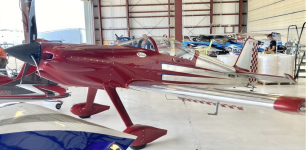

Com antenna locations
Freemasm
Patron
Boundary Conditions =
2 com radios ->
2 com antennas
Small belly area
Tried looking at Rocket pix that I’ve taken, forum pix, etc
For two antenna installs, it appears most are parallel, spaced as wide as physically possible (less than three feet). Most appear to be in the bays behind the spar. At least one appears to be in the bays forward of the spar.
Let me know where yours are and:
Any problems with re-radiation?
Other issues?
Any novel approaches?
Would you do it differently if you could?
Sorry and thx. Always get nervous when about to cut holes in fuse skin.

Some options:
- Mount the antennas off center and fore/aft to gain separation.
- Consider a wingtip mounted Comm 2 antenna.
As we know, the Archer wingtip comm antenna is a poor performer. I can say you can make your own antenna that works halfway decent. It will not be as good as a bent whip on the belly but will be adequate for Comm 2. I ran such an antenna for my single comm on my first build for a couple of years and was able to communicate as needed. The data point I can offer is flying side by side with another RV using the Archer wingtip comm antenna I had to relay ATC comms for him as ATC could not hear him.
The approach is to take the basic wingtip antenna design out of the AeroElectric bible, lengthen the arm that moves out from the wing rib as much as possible and get as much vertical drop (or rise) in that arm as the wingtip allows. As in mounting the base on the bottom of the outboard rib and angling the arm to the upper, outboard wingtip edge. Remember the first third of a quarter wavelength antenna is the high current area (the part that does most the work) and vertical polarization is preferred. The arm going fore and aft is shorten to compensate for this extra length. Find a ham radio guy to help you on this.

I started out with:
1) bent whip on bottom and archer in left wing.
-archer wasn't good in wing tip
2) Bent whip on bottom and tried to hide 18 inch handheld antenna in the gear leg fairing
-18 inch antenna in gear leg didn't work
3) two bent whip antennas in the center of the plane about 3 feet apart.
-works perfect
What I did learn later was that likely the archer antenna would have worked better if it was contoured with the leading edge of the wingtip... but I have landing lights there and there was no space.
My goal for com 2 antenna was just to be able to talk to a formation of planes. Options 1 and 2 were no bueno.
